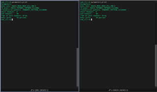

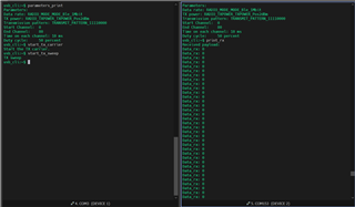

&lt;p&gt;I&amp;#39;m not seeing any immediate mistakes in the code. Did you get any further with debugging this?&lt;/p&gt;&lt;div style="clear:both;"&gt;&lt;/div&gt;</description></item><item><title>RE: Issues adapting the Radio Test sample to our custom hardware which is using the nRF52840 SoC</title><link>https://devzone.nordicsemi.com/thread/371988?ContentTypeID=1</link><pubDate>Sun, 12 Jun 2022 17:07:22 GMT</pubDate><guid isPermaLink="false">137ad170-7792-4731-bb38-c0d22fbe4515:38514879-da5e-4655-bae1-372ea23f0a48</guid><dc:creator>Mihael01</dc:creator><description>&lt;p&gt;Hello,&lt;/p&gt;
&lt;p&gt;My bad I should have been more specific. We are using the high frequency crystal of the Laird BL654 module and do not have an external high frequency crystal on our board (or a low frequency one for that matter).&lt;/p&gt;
&lt;p&gt;Hope this helps!&lt;/p&gt;&lt;div style="clear:both;"&gt;&lt;/div&gt;</description></item><item><title>RE: Issues adapting the Radio Test sample to our custom hardware which is using the nRF52840 SoC</title><link>https://devzone.nordicsemi.com/thread/371908?ContentTypeID=1</link><pubDate>Fri, 10 Jun 2022 12:54:54 GMT</pubDate><guid isPermaLink="false">137ad170-7792-4731-bb38-c0d22fbe4515:2686d937-bdf2-4a21-8f1c-98fef5a40428</guid><dc:creator>Sigurd</dc:creator><description>&lt;p&gt;Hi,&lt;/p&gt;
[quote user=""]The Radio Test example comes using UART and the external high frequency crystal oscillator which both have to be adapted to suite our hardware. This is why I set in the sdk_config.h file the NRFX_CLOCK_CONFIG_LF_SRC to 0,&amp;nbsp;CLOCK_CONFIG_LF_SRC to 0, and&amp;nbsp;CLOCK_CONFIG_LF_CAL_ENABLED 1 (to match the settings of our existing hardware).[/quote]
&lt;p&gt;You have an external high frequency crystal on your board, right?&lt;/p&gt;&lt;div style="clear:both;"&gt;&lt;/div&gt;</description></item></channel></rss>
