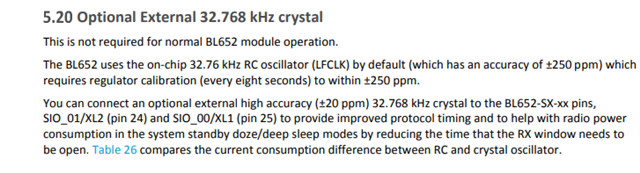

&lt;p&gt;&lt;img src="https://devzone.nordicsemi.com/resized-image/__size/640x480/__key/communityserver-discussions-components-files/4/pastedimage1654858903154v1.png" alt=" " /&gt;&lt;/p&gt;
&lt;p&gt;So yes, if you build for&amp;nbsp;bl652_dvk board,&amp;nbsp;CONFIG_CLOCK_CONTROL_NRF_K32SRC_RC will bet set to y:&lt;/p&gt;
&lt;p&gt;&lt;a href="https://github.com/nrfconnect/sdk-zephyr/blob/main/boards/arm/bl652_dvk/bl652_dvk_defconfig#L27"&gt;https://github.com/nrfconnect/sdk-zephyr/blob/main/boards/arm/bl652_dvk/bl652_dvk_defconfig#L27&lt;/a&gt;&lt;/p&gt;

&lt;p&gt;I&amp;#39;m thinking either&amp;nbsp;&lt;/p&gt;
&lt;p&gt;1) The module does not have external LF crystal. In that case, set this config:&lt;/p&gt;
&lt;div&gt;CONFIG_CLOCK_CONTROL_NRF_K32SRC_RC=y&lt;/div&gt;

&lt;div&gt;2) The module does not have DCDC components. In that case,&amp;nbsp;try setting this:&lt;/div&gt;
&lt;div&gt;&lt;/div&gt;
&lt;div&gt;&lt;span&gt;CONFIG_BOARD_ENABLE_DCDC=n&lt;/span&gt;&lt;/div&gt;&lt;div style="clear:both;"&gt;&lt;/div&gt;</description></item></channel></rss>
