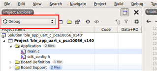

&lt;p&gt;I need more information to go on. As a start, please select the &amp;quot;Debug&amp;quot; build configuration if you use Segger embedded studio. This will make the error handler print a crashlog with the actual error code and where it occurred rather than just saying &amp;quot;Fatal error&amp;quot;.&lt;/p&gt;
&lt;p&gt;&lt;img src="https://devzone.nordicsemi.com/resized-image/__size/320x240/__key/communityserver-discussions-components-files/4/pastedimage1655115144972v1.png" alt=" " /&gt;&lt;/p&gt;
