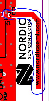

&lt;p&gt;thanks for your support.&lt;/p&gt;&lt;div style="clear:both;"&gt;&lt;/div&gt;</description></item><item><title>RE: nRF52840-CKAA-R(WLCSP-94) Frequency generate internally or externally</title><link>https://devzone.nordicsemi.com/thread/372488?ContentTypeID=1</link><pubDate>Wed, 15 Jun 2022 07:47:11 GMT</pubDate><guid isPermaLink="false">137ad170-7792-4731-bb38-c0d22fbe4515:993d28ea-901d-4f42-8298-d5a20ff5d7a9</guid><dc:creator>ketiljo</dc:creator><description>&lt;p&gt;If you make it ~23 mm long, 2-3 mm wide and a distance to the ground plane of more than 10 mm, you should be fine. You need to trim the length for max range in your product as it will vary a bit with the size of the ground plane. Meaning that can&amp;#39;t just copy the DK antenna 1:1, but it&amp;#39;s a good start.&lt;/p&gt;
&lt;p&gt;&lt;/p&gt;&lt;div style="clear:both;"&gt;&lt;/div&gt;</description></item><item><title>RE: nRF52840-CKAA-R(WLCSP-94) Frequency generate internally or externally</title><link>https://devzone.nordicsemi.com/thread/372340?ContentTypeID=1</link><pubDate>Tue, 14 Jun 2022 10:11:01 GMT</pubDate><guid isPermaLink="false">137ad170-7792-4731-bb38-c0d22fbe4515:92a37031-df01-4c53-b5eb-877db1e22811</guid><dc:creator>Hitesh soramiya</dc:creator><description>&lt;p&gt;Could you please share the on board antenna trace width size, its length and corner dimensions?&lt;/p&gt;
&lt;p&gt;Thank you.&amp;nbsp;&lt;/p&gt;&lt;div style="clear:both;"&gt;&lt;/div&gt;</description></item><item><title>RE: nRF52840-CKAA-R(WLCSP-94) Frequency generate internally or externally</title><link>https://devzone.nordicsemi.com/thread/372320?ContentTypeID=1</link><pubDate>Tue, 14 Jun 2022 08:56:05 GMT</pubDate><guid isPermaLink="false">137ad170-7792-4731-bb38-c0d22fbe4515:19f93056-5237-4ac0-8aa7-9be5423e2670</guid><dc:creator>ketiljo</dc:creator><description>&lt;p&gt;Yes, this is what you need.&lt;/p&gt;&lt;div style="clear:both;"&gt;&lt;/div&gt;</description></item><item><title>RE: nRF52840-CKAA-R(WLCSP-94) Frequency generate internally or externally</title><link>https://devzone.nordicsemi.com/thread/372319?ContentTypeID=1</link><pubDate>Tue, 14 Jun 2022 08:55:35 GMT</pubDate><guid isPermaLink="false">137ad170-7792-4731-bb38-c0d22fbe4515:8cf94a59-de99-487f-8dfa-f5ebcbe1c8c5</guid><dc:creator>ketiljo</dc:creator><description>&lt;p&gt;Well, if you don&amp;#39;t need to use the radio, you don&amp;#39;t need the antenna. Else, you will indeed need the antenna.&amp;nbsp;&lt;/p&gt;
&lt;p&gt;I suggest you look for a module, that will make it easier for you to get started:&amp;nbsp;&lt;a href="https://www.nordicsemi.com/Nordic-Partners/3rd-party-modules"&gt;https://www.nordicsemi.com/Nordic-Partners/3rd-party-modules&lt;/a&gt;&lt;/p&gt;&lt;div style="clear:both;"&gt;&lt;/div&gt;</description></item><item><title>RE: nRF52840-CKAA-R(WLCSP-94) Frequency generate internally or externally</title><link>https://devzone.nordicsemi.com/thread/372317?ContentTypeID=1</link><pubDate>Tue, 14 Jun 2022 08:52:46 GMT</pubDate><guid isPermaLink="false">137ad170-7792-4731-bb38-c0d22fbe4515:6da1a604-81e3-4da1-bc5d-27567ca507e1</guid><dc:creator>Hitesh soramiya</dc:creator><description>&lt;p&gt;&lt;span style="color:#000000;"&gt;&lt;span style="font-size:small;"&gt;&lt;span style="font-family:&amp;#39;Times New Roman&amp;#39;, serif;"&gt;We have observed below trace which is onboard antenna?&lt;/span&gt;&lt;/span&gt;&lt;/span&gt;&lt;/p&gt;
&lt;p&gt;&lt;span style="color:#000000;"&gt;&lt;span style="font-size:small;"&gt;&lt;span style="font-family:&amp;#39;Times New Roman&amp;#39;, serif;"&gt;What we have understood is right?&lt;/span&gt;&lt;/span&gt;&lt;/span&gt;&lt;/p&gt;
&lt;p&gt;&lt;span style="color:#000000;"&gt;&lt;span style="font-size:small;"&gt;&lt;span style="font-family:&amp;#39;Times New Roman&amp;#39;, serif;"&gt;Please refer below snapshot&lt;/span&gt;&lt;/span&gt;&lt;/span&gt;&lt;/p&gt;
&lt;p&gt;&lt;span style="color:#000000;"&gt;&lt;span style="font-size:small;"&gt;&lt;span style="font-family:&amp;#39;Times New Roman&amp;#39;, serif;"&gt;&lt;img src="https://devzone.nordicsemi.com/resized-image/__size/640x480/__key/communityserver-discussions-components-files/4/pastedimage1655196736514v1.png" alt=" " /&gt;&lt;/span&gt;&lt;/span&gt;&lt;/span&gt;&lt;/p&gt;
&lt;p&gt;&lt;span style="color:#000000;"&gt;&lt;span style="font-size:small;"&gt;&lt;span style="font-family:&amp;#39;Times New Roman&amp;#39;, serif;"&gt;&lt;/span&gt;&lt;/span&gt;&lt;/span&gt;&lt;/p&gt;
