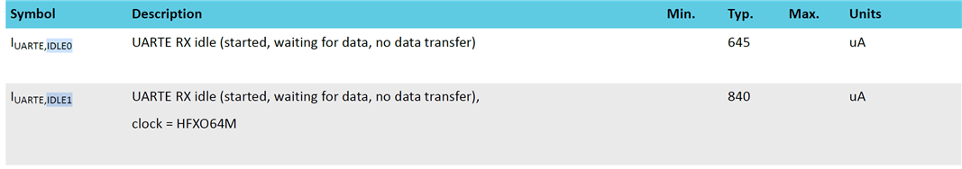

 We are developing our own uart driver, and need to understand the power consumption of the peripheral.
 According to the product specification section electrical specifications, there seems to be a uart idle0 and idle1 state.
 Could you</description><dc:language>en-US</dc:language><generator>Telligent Community 13</generator><lastBuildDate>Mon, 15 Aug 2022 17:49:09 GMT</lastBuildDate><atom:link rel="self" type="application/rss+xml" href="https://devzone.nordicsemi.com/f/nordic-q-a/90990/uarte-power-consumption-clarification" /><item><title>RE: UARTE power consumption clarification</title><link>https://devzone.nordicsemi.com/thread/381636?ContentTypeID=1</link><pubDate>Mon, 15 Aug 2022 17:49:09 GMT</pubDate><guid isPermaLink="false">137ad170-7792-4731-bb38-c0d22fbe4515:0a415c00-ecdd-4c04-9641-a0ff3b2724ea</guid><dc:creator>Sigurd</dc:creator><description>[quote user=""]From what clock is the peripheral running in idle0?[/quote]
&lt;p&gt;HFCLK=HFINT running at 64 MHz.&amp;nbsp;&lt;a href="https://infocenter.nordicsemi.com/topic/ps_nrf5340/chapters/current_consumption/doc/current_consumption.html?cp=3_0_0_3_3"&gt;https://infocenter.nordicsemi.com/topic/ps_nrf5340/chapters/current_consumption/doc/current_consumption.html?cp=3_0_0_3_3&lt;/a&gt;&lt;/p&gt;&lt;div style="clear:both;"&gt;&lt;/div&gt;</description></item></channel></rss>
