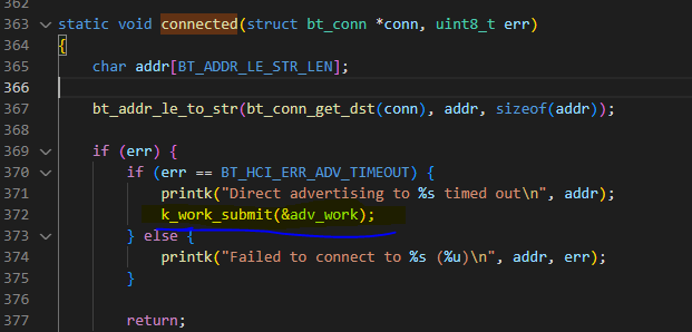

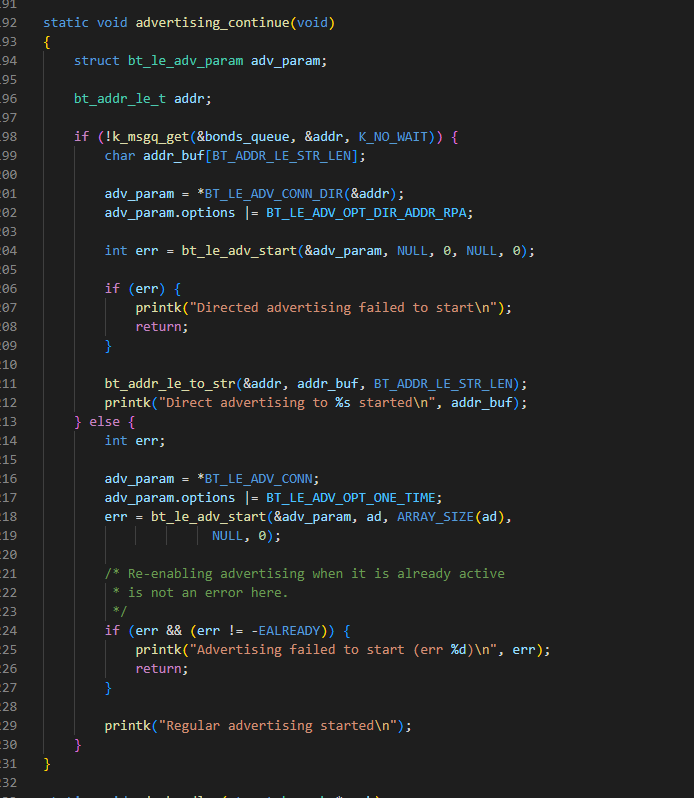

&lt;p&gt;From what I can see from the code, after waking up from NFC, it will cycle through the bonded device list with the directed advertising. Each time the directed advertising timeout it will cycle to the next bonded device in the list and continue directed advertising. When the list is over, it will do the normal advertising.&amp;nbsp;&lt;br /&gt;Here is when it loops through the list of bonded device to do directed advertising and do regular advertising if the list is over:&amp;nbsp;&lt;/p&gt;
&lt;p&gt;&lt;img style="max-height:457px;max-width:398px;" alt=" " src="https://devzone.nordicsemi.com/resized-image/__size/796x914/__key/communityserver-discussions-components-files/4/pastedimage1663579454286v1.png" /&gt;&lt;/p&gt;
&lt;p&gt;&lt;/p&gt;
&lt;p&gt;Here is when the directed advertising timeout (1.25ms):&amp;nbsp;&lt;/p&gt;
&lt;p&gt;&lt;img style="max-height:240px;max-width:320px;" src="https://devzone.nordicsemi.com/resized-image/__size/640x480/__key/communityserver-discussions-components-files/4/pastedimage1663579505787v2.png" alt=" " /&gt;&lt;/p&gt;
&lt;p&gt;&lt;br /&gt;So in your case it should do normal advertising after the timeout.&amp;nbsp;&lt;br /&gt;What do you see when you connect the second phone to it ?&amp;nbsp;&lt;br /&gt;&lt;br /&gt;In my case here when I test with my phone, I had an issue that a new bond is started with my phone everytime I bring the phone to wake the board up. Maybe something to do with the phone that it wants to do new pairing when reading NFC.&amp;nbsp;&lt;/p&gt;&lt;div style="clear:both;"&gt;&lt;/div&gt;</description></item><item><title>RE: NFC Pairing with Type 2 versus Type 4 Tag</title><link>https://devzone.nordicsemi.com/thread/386732?ContentTypeID=1</link><pubDate>Sat, 17 Sep 2022 11:18:21 GMT</pubDate><guid isPermaLink="false">137ad170-7792-4731-bb38-c0d22fbe4515:989dd486-5f8a-455e-bc53-36b4faef7af7</guid><dc:creator>WesC</dc:creator><description>&lt;p&gt;Hung&lt;/p&gt;
