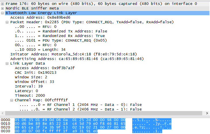

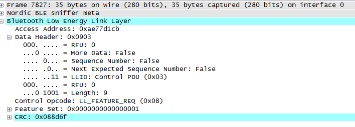

&lt;p&gt;seems a pretty poor situation! Is this common?&lt;/p&gt;&lt;div style="clear:both;"&gt;&lt;/div&gt;</description></item><item><title>RE: Possible causes of GATT 133 (0x85)?</title><link>https://devzone.nordicsemi.com/thread/33951?ContentTypeID=1</link><pubDate>Mon, 14 Sep 2015 12:01:33 GMT</pubDate><guid isPermaLink="false">137ad170-7792-4731-bb38-c0d22fbe4515:5bce874b-39f2-4af7-ab1c-5c3a314a198d</guid><dc:creator>Torsten Robitzki</dc:creator><description>&lt;p&gt;The seq1 and seq2 seams identical to me. In both files the master requests a hop value of 21. According to 2.3.3.1 the hop value should be in the range 5 to 16. In addition, is the &amp;quot;next expected sequence number&amp;quot; field set to 1. I think it should be set to 0. So to me it looks like the stack on your Moto G seems to be broken.&lt;/p&gt;&lt;div style="clear:both;"&gt;&lt;/div&gt;</description></item><item><title>RE: Possible causes of GATT 133 (0x85)?</title><link>https://devzone.nordicsemi.com/thread/33950?ContentTypeID=1</link><pubDate>Mon, 14 Sep 2015 11:44:40 GMT</pubDate><guid isPermaLink="false">137ad170-7792-4731-bb38-c0d22fbe4515:d8e1e2a1-a93a-4aba-a91a-55a24ea13fb5</guid><dc:creator>Lionel Sacks</dc:creator><description>&lt;p&gt;Sure, just took me a moment to figure in Wirshark...&lt;/p&gt;

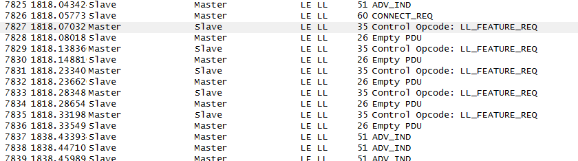

&lt;p&gt;seq&lt;/p&gt;
&lt;p&gt;&lt;a href="https://devzone.nordicsemi.com/cfs-file/__key/communityserver-discussions-components-files/4/seq2.PNG"&gt;seq2.PNG&lt;/a&gt;&lt;/p&gt;

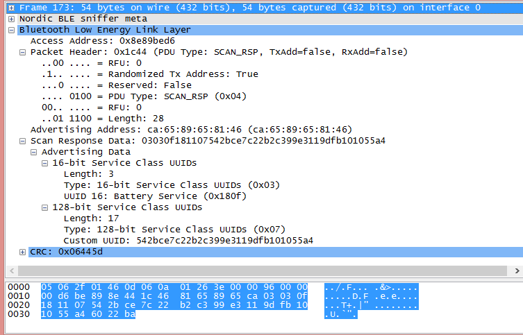

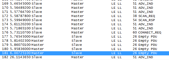

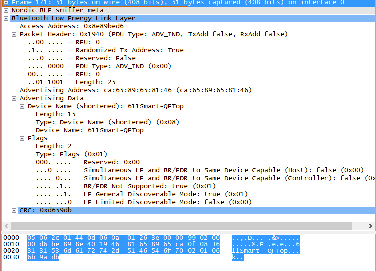

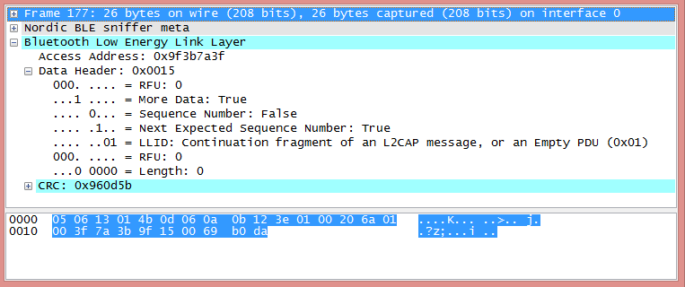

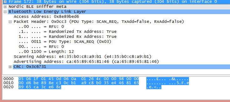

&lt;p&gt;&lt;a href="https://devzone.nordicsemi.com/cfs-file/__key/communityserver-discussions-components-files/4/LL_5F00_FEATURE.PNG"&gt;LL_FEATURE.PNG&lt;/a&gt;&lt;/p&gt;&lt;div style="clear:both;"&gt;&lt;/div&gt;</description></item><item><title>RE: Possible causes of GATT 133 (0x85)?</title><link>https://devzone.nordicsemi.com/thread/33945?ContentTypeID=1</link><pubDate>Mon, 14 Sep 2015 10:19:21 GMT</pubDate><guid isPermaLink="false">137ad170-7792-4731-bb38-c0d22fbe4515:fc57b8c1-e576-4255-8281-35c7d0a82712</guid><dc:creator>Lionel Sacks</dc:creator><description>&lt;p&gt;From wireshark - if this helps:&lt;/p&gt;
&lt;p&gt;&lt;a href="https://devzone.nordicsemi.com/cfs-file/__key/communityserver-discussions-components-files/4/seq.PNG"&gt;seq.PNG&lt;/a&gt;&lt;/p&gt;
&lt;p&gt;adv ind
&lt;a href="https://devzone.nordicsemi.com/cfs-file/__key/communityserver-discussions-components-files/4/advind.PNG"&gt;advind.PNG&lt;/a&gt;&lt;/p&gt;
&lt;p&gt;scan req
&lt;a href="https://devzone.nordicsemi.com/cfs-file/__key/communityserver-discussions-components-files/4/scan_5F00_req.PNG"&gt;scan_req.PNG&lt;/a&gt;&lt;/p&gt;
&lt;p&gt;scan resp
&lt;a href="https://devzone.nordicsemi.com/cfs-file/__key/communityserver-discussions-components-files/4/scan_5F00_resp.PNG"&gt;scan_resp.PNG&lt;/a&gt;&lt;/p&gt;
&lt;p&gt;connect_req
&lt;a href="https://devzone.nordicsemi.com/cfs-file/__key/communityserver-discussions-components-files/4/conn_5F00_req.PNG"&gt;conn_req.PNG&lt;/a&gt;&lt;/p&gt;
&lt;p&gt;empty PDU?!?
&lt;a href="https://devzone.nordicsemi.com/cfs-file/__key/communityserver-discussions-components-files/4/empty.PNG"&gt;empty.PNG&lt;/a&gt;&lt;/p&gt;&lt;div style="clear:both;"&gt;&lt;/div&gt;</description></item><item><title>RE: Possible causes of GATT 133 (0x85)?</title><link>https://devzone.nordicsemi.com/thread/33944?ContentTypeID=1</link><pubDate>Mon, 14 Sep 2015 09:16:40 GMT</pubDate><guid isPermaLink="false">137ad170-7792-4731-bb38-c0d22fbe4515:b1521cf9-4d57-4892-88ba-cc5115195695</guid><dc:creator>Lionel Sacks</dc:creator><description>&lt;p&gt;ps.
I see nothing of use on wireshark
When I try and fail to connect from the Android MCP, the device goes into a long timeout before re-starting adverting... consistent, I guess with the connection supervisory timeout,&lt;/p&gt;&lt;div style="clear:both;"&gt;&lt;/div&gt;</description></item></channel></rss>
