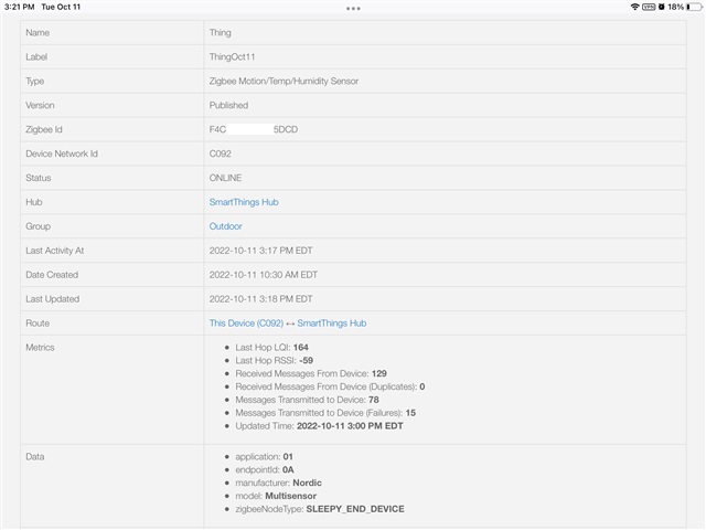

&lt;p class="p2"&gt;&lt;span class="s1"&gt;Just a quick FYI that removing pressure from Nordic example didn&amp;rsquo;t correct the issue, and type of &amp;ldquo;Thing&amp;rdquo; was still showing as device type in SmartThings hub. &lt;/span&gt;&lt;/p&gt;
&lt;p class="p2"&gt;&lt;span class="s1"&gt;Detected &amp;ldquo;Thing&amp;rdquo; type as I mentioned in previous post was actually just a first selection in Smartthings drop-down box that is &amp;ldquo;2015 Samsung Smart TV&amp;rdquo;.&lt;/span&gt;&lt;/p&gt;
&lt;p class="p1"&gt;&lt;span class="s1"&gt;&lt;/span&gt;&lt;/p&gt;
&lt;p class="p2"&gt;&lt;span class="s1"&gt;Whole issue and way to correct it, is related to providing correct fingerprint. Fingerprint is needed to avoid getting &amp;ldquo;Thing&amp;rdquo; type and to get at least some manufacturer model through auto-scan. &lt;/span&gt;&lt;/p&gt;
&lt;p class="p2"&gt;&lt;span class="s1"&gt;I was able to somewhat make it work, i.e. detect simulated motion sensor by SW2 button pressing, so far by:&lt;/span&gt;&lt;/p&gt;
&lt;p class="p2"&gt;&lt;span class="s1"&gt;1) adding motion instead of pressure (temp can stay or can be removed)&lt;/span&gt;&lt;/p&gt;
&lt;p class="p2"&gt;&lt;span class="s1"&gt;2) setting Manufacturer name and Model (from zigbee-plugin-motion-sensor.groovy) &lt;/span&gt;&lt;/p&gt;
&lt;p class="p2"&gt;&lt;span class="s1"&gt;3) using nrfx_gpiote_in_is_set to detect press on SW2 &lt;/span&gt;&lt;/p&gt;
&lt;p class="p2"&gt;&lt;span class="s1"&gt;4) using zb_zcl_set_attr_val to send occupied value to SmartThings hub&lt;/span&gt;&lt;/p&gt;
&lt;p class="p2"&gt;&lt;span class="s1"&gt;Note that SmartThings auto-scan, after detecting sensor, will assign it correct read-only type of &amp;ldquo;placeholder&amp;rdquo;.&lt;/span&gt;&lt;/p&gt;
&lt;p class="p2"&gt;&lt;span class="s1"&gt;Due to the lack of, or my inability to find, &amp;ldquo;generic&amp;rdquo; Manufacturer name and Model in SmartThings for zigbee motion/battery/temp/etc sensors, this approach is not really useable in production, unless one is able to get approval from Manufacturer mentioned in groovy file, or able to write SmartThings Edge driver (mandatory groovy replacement).&lt;/span&gt;&lt;/p&gt;

&lt;p&gt;As you have realised these compability issue only appears with multi_sensor example. The main reason is that &lt;span&gt;this Zigbee Multi Sensor example&amp;nbsp;added a&amp;nbsp;custom cluster implemented for pressure in zb_zcl_pressure_measurement.h and zb_zcl_pressure_measurement.c.This cluster is not like temperature&amp;nbsp;defined by the ZCL specification, so it will confuse other standered devices and cause different compibility issues if you add it to other Zigbee hubs.&lt;/span&gt;&lt;/p&gt;

&lt;p&gt;&lt;br /&gt;Workaround suggested re adjusting detected sensor type at Smartthings web account, is really not something that I can pass to future customers.&lt;br /&gt;None of the nrf52 related sensor code (mostly from github), other that light bulb/lock related, doesn&amp;#39;t seems able to seamlessly join Smarthings or join at least standard Zigbee hub in Tuya. &lt;br /&gt;&lt;br /&gt;In the meantime I did order few Zigbee sensors made with different manufacturer&amp;#39;s SoC other than Nordic nrf52xx SoC; those sensors are joining okay both Smartthings and standard Zigbee hubs under Tuya. In addition I did check one SoC manufacturer&amp;#39;s zigbee sensor IAR source code.&lt;br /&gt;Their official code from github and its Tuya implementation, that apparently is working, seems to not have/use basic attribute list nor identify attribute list: &lt;br /&gt;&lt;br /&gt;Contact sensor IAR code - non-nrf52 - working with Tuya/Smarthings:&amp;nbsp;&amp;nbsp;&amp;nbsp;&amp;nbsp;&amp;nbsp;&amp;nbsp;&amp;nbsp;&amp;nbsp;&amp;nbsp;&amp;nbsp;&amp;nbsp;&amp;nbsp;&amp;nbsp;&amp;nbsp;&amp;nbsp;&amp;nbsp;&amp;nbsp;&amp;nbsp;&amp;nbsp;&amp;nbsp;&amp;nbsp;&amp;nbsp;&amp;nbsp;&amp;nbsp;&amp;nbsp;&amp;nbsp;&amp;nbsp;&amp;nbsp;&amp;nbsp;&amp;nbsp;&amp;nbsp;&amp;nbsp;&amp;nbsp; &amp;nbsp;&lt;br /&gt;// application cluster&lt;br /&gt;const cluster_t app_server_cluster_list[] ={&lt;br /&gt;&amp;nbsp;&amp;nbsp;&amp;nbsp; DEF_CLUSTER_POWER_CLUSTER_ID( power_attr_list )&lt;br /&gt;&amp;nbsp;&amp;nbsp;&amp;nbsp; DEF_CLUSTER_IAS_ZONE_CLUSTER_ID( ias_zone_attr_list )&lt;br /&gt;};&lt;br /&gt;&lt;br /&gt;Multi sensor SES code - nrf52 - not working with Tuya/Smarthings: &lt;br /&gt;ZB_DECLARE_MULTI_SENSOR_CLUSTER_LIST(multi_sensor_clusters,&lt;br /&gt;&amp;nbsp;&amp;nbsp;&amp;nbsp;&amp;nbsp;&amp;nbsp;&amp;nbsp;&amp;nbsp;&amp;nbsp;&amp;nbsp;&amp;nbsp;&amp;nbsp;&amp;nbsp;&amp;nbsp;&amp;nbsp;&amp;nbsp;&amp;nbsp;&amp;nbsp;&amp;nbsp;&amp;nbsp;&amp;nbsp;&amp;nbsp;&amp;nbsp;&amp;nbsp;&amp;nbsp;&amp;nbsp;&amp;nbsp;&amp;nbsp;&amp;nbsp;&amp;nbsp;&amp;nbsp;&amp;nbsp;&amp;nbsp;&amp;nbsp;&amp;nbsp;&amp;nbsp;&amp;nbsp; basic_attr_list,&lt;br /&gt;&amp;nbsp;&amp;nbsp;&amp;nbsp;&amp;nbsp;&amp;nbsp;&amp;nbsp;&amp;nbsp;&amp;nbsp;&amp;nbsp;&amp;nbsp;&amp;nbsp;&amp;nbsp;&amp;nbsp;&amp;nbsp;&amp;nbsp;&amp;nbsp;&amp;nbsp;&amp;nbsp;&amp;nbsp;&amp;nbsp;&amp;nbsp;&amp;nbsp;&amp;nbsp;&amp;nbsp;&amp;nbsp;&amp;nbsp;&amp;nbsp;&amp;nbsp;&amp;nbsp;&amp;nbsp;&amp;nbsp;&amp;nbsp;&amp;nbsp;&amp;nbsp;&amp;nbsp;&amp;nbsp; identify_client_attr_list,&lt;br /&gt;&amp;nbsp;&amp;nbsp;&amp;nbsp;&amp;nbsp;&amp;nbsp;&amp;nbsp;&amp;nbsp;&amp;nbsp;&amp;nbsp;&amp;nbsp;&amp;nbsp;&amp;nbsp;&amp;nbsp;&amp;nbsp;&amp;nbsp;&amp;nbsp;&amp;nbsp;&amp;nbsp;&amp;nbsp;&amp;nbsp;&amp;nbsp;&amp;nbsp;&amp;nbsp;&amp;nbsp;&amp;nbsp;&amp;nbsp;&amp;nbsp;&amp;nbsp;&amp;nbsp;&amp;nbsp;&amp;nbsp;&amp;nbsp;&amp;nbsp;&amp;nbsp;&amp;nbsp;&amp;nbsp; identify_server_attr_list,&lt;br /&gt;&amp;nbsp;&amp;nbsp;&amp;nbsp;&amp;nbsp;&amp;nbsp;&amp;nbsp;&amp;nbsp;&amp;nbsp;&amp;nbsp;&amp;nbsp;&amp;nbsp;&amp;nbsp;&amp;nbsp;&amp;nbsp;&amp;nbsp;&amp;nbsp;&amp;nbsp;&amp;nbsp;&amp;nbsp;&amp;nbsp;&amp;nbsp;&amp;nbsp;&amp;nbsp;&amp;nbsp;&amp;nbsp;&amp;nbsp;&amp;nbsp;&amp;nbsp;&amp;nbsp;&amp;nbsp;&amp;nbsp;&amp;nbsp;&amp;nbsp;&amp;nbsp;&amp;nbsp;&amp;nbsp; temperature_attr_list,&lt;br /&gt;&amp;nbsp;&amp;nbsp;&amp;nbsp;&amp;nbsp;&amp;nbsp;&amp;nbsp;&amp;nbsp;&amp;nbsp;&amp;nbsp;&amp;nbsp;&amp;nbsp;&amp;nbsp;&amp;nbsp;&amp;nbsp;&amp;nbsp;&amp;nbsp;&amp;nbsp;&amp;nbsp;&amp;nbsp;&amp;nbsp;&amp;nbsp;&amp;nbsp;&amp;nbsp;&amp;nbsp;&amp;nbsp;&amp;nbsp;&amp;nbsp;&amp;nbsp;&amp;nbsp;&amp;nbsp;&amp;nbsp;&amp;nbsp;&amp;nbsp;&amp;nbsp;&amp;nbsp;&amp;nbsp; pressure_attr_list);&lt;br /&gt;&lt;br /&gt;&lt;br /&gt;I really prefer to continue with Nordic SoC and SES, due to easy coding, detailed comments, as well as due to the time and investment put into development so far, but uncertainty/inability to work with major physical hub(s) is show stopper.&lt;br /&gt;&lt;br /&gt;Thanks in advance&lt;/p&gt;&lt;div style="clear:both;"&gt;&lt;/div&gt;</description></item><item><title>RE: Multi_sensor Zigbee example - wrong device type using official Nordic nrf52840DK</title><link>https://devzone.nordicsemi.com/thread/390525?ContentTypeID=1</link><pubDate>Wed, 12 Oct 2022 22:09:38 GMT</pubDate><guid isPermaLink="false">137ad170-7792-4731-bb38-c0d22fbe4515:a125e191-dc5d-475a-af54-8c7efbd8ba77</guid><dc:creator>inixie</dc:creator><description>&lt;p&gt;Thanks Elfving,&lt;/p&gt;
&lt;p&gt;In initial attachment was sniffer log for Smartthings on channel 14, and here is sniffer log for Tuya on channel 15.&lt;/p&gt;
&lt;p&gt;As per advice for adjusting Smartthings sensor type at Samsung website, I did attempt that, with mixed results (screenshots attached showing intermittent successful change). Basically sometime it works, but sensor did appear differently after repeated adjustments (sensor either shows just &amp;quot;Connected&amp;quot; or do show values like Temp etc). This behavior seems to partially depend on device initially chosen to do the scan (auto-scan doesn&amp;#39;t seems to work). Initially I was able to change &amp;quot;Thing&amp;quot; (first choice of all devices in the list, maybe due to passing wrong ID to Smartthins) type to Zigbee Motion/Temp/Humidity Sensor. Unfortunately I wasn&amp;#39;t able to replicate it consistently.&lt;/p&gt;
&lt;p&gt;&lt;a href="https://devzone.nordicsemi.com/cfs-file/__key/communityserver-discussions-components-files/4/Capturemulti_2D00_sensorChannel15Tuya.pcapng"&gt;devzone.nordicsemi.com/.../Capturemulti_2D00_sensorChannel15Tuya.pcapng&lt;/a&gt;&lt;img style="max-height:240px;max-width:320px;" alt=" " src="https://devzone.nordicsemi.com/resized-image/__size/640x480/__key/communityserver-discussions-components-files/4/Samsung-website-account-re-Zigbee-device-type-adjustment.jpg" /&gt;&lt;img style="max-height:240px;max-width:320px;" alt=" " src="https://devzone.nordicsemi.com/resized-image/__size/640x480/__key/communityserver-discussions-components-files/4/Smartthings-appearance-in-app.jpg" /&gt;&lt;/p&gt;&lt;div style="clear:both;"&gt;&lt;/div&gt;</description></item><item><title>RE: Multi_sensor Zigbee example - wrong device type using official Nordic nrf52840DK</title><link>https://devzone.nordicsemi.com/thread/390209?ContentTypeID=1</link><pubDate>Tue, 11 Oct 2022 09:17:27 GMT</pubDate><guid isPermaLink="false">137ad170-7792-4731-bb38-c0d22fbe4515:c58aa804-6693-4a94-a10a-00d84ed32de5</guid><dc:creator>Elfving</dc:creator><description>&lt;p&gt;Hello again,&lt;/p&gt;
