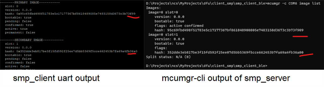

Dear Sigurd,
Since this is a relatively recent thread, I thought I quickly chime in to also write down my observations about your smp_client_ble example (which is really useful btw in light of no official examples...).
I'm seeing similar issues with NCS 2.2.0 and NCS 2.3.0 as well.
Reading a bunch of threads in the forum, I think it will be really nice once your mentioned PR will be merged, and/or will be included in the NCS.
