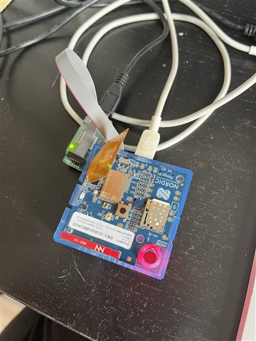

Hello everyone,
there seems to be an issue with my programm I am unable to solve. When I flash/reset the thingy via VSCode with Segger J-Link mini EDU and USB it boots just fine and the application runs even if I disconnect it after. But if I try to reset it just with the J-link without the USB or simply by a power-on reset it doesn't do anything.
The battery is fine and when f.e. the blinky demo is flashed it works without issues. What am I missing?
Thanks for your help.
The app is supposed to first connect to the network, then measure the airquality and send a message via MQTT. After that go to sleep for 5 mins and repeat.

    Could you send me a picture of your whole set-up. Like how thingy is connected to Segger J-Link mini EDU and USB?

  • Here you go. Just before taking the picture I hit the "reset board" in VS Code so the LED light up.
    Sorry I couldn't find a real reason for this issue. But can you once cross check your configuration file with the sample configuration(uner:C:\ncs\v2.4.0\nrf\samples\net\mqtt) I pointed out in my last response. I also recommend you to go through this tutorial and see if you have missed or added anything. You can also share your prj.conf file to have better insight into this.

    Sorry I couldn't find an issue in here. The only thing I can think of here is because of low power while flashing or nRF52 in the thingy is not properly powered by the External debug probe. Do you have an nRF9160 DK which could act as an external debugger? May be you can give a shot by using 9160dk.
