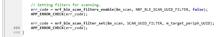

    I rebuilt the ble_app_blinky_c using the DEBUG as described above and this was the resultant output:
    <info> app_timer: RTC: initialized.
    <error> app: ERROR 7 [NRF_ERROR_INVALID_PARAM] at C:\Allen_Data\local_projs\nRF5_SDK_17.1.0_ddde560\examples\ble_central\ble_app_blinky_c\main.c:489
    PC at: 0x0002EB7D
    <error> app: End of error report
    When I look at the line number, it has to do with the name of the device.  See the code I included in a previous reply.  The line number referenced is the same as line 14 shown above.  I am inserting an image of a screenshot from the application that shows the line number as well.
    I have tried m_target_periph_UUID as it is shown and as &m_target_periph_UUID[0].  Both give the same results.
    The definition for the m_target_periph_UUID is shown in the previous code snippet I sent earlier.
    Any ideas?
