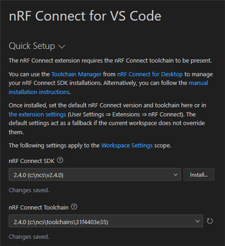

Currently I've gone back to the blinky application under the Zephyr samples in the SDK folder. I'm using SDK v.2.4.0 and am able to build the blinky application for the thingy53_nrf5340_cpuapp_ns without issue. The problem comes after I flash or debug.

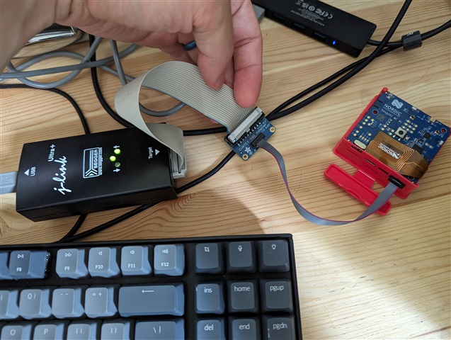

    I'm not sure why you aren't seeing this issue. I've been able to recreate the problem across both Windows and Mac OS host systems using multiple Thingy53 dev boards and a variety of external programmers both a seggar JLink Ultra and nRF5340DK. I've tried programming via VSCode with the nRF Extension, the nRF Connect Programmer and the command line tools. All result in the same behavior.

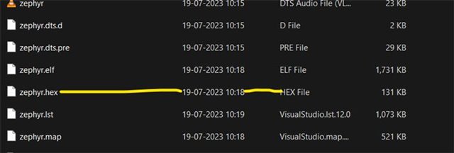

    Can you try any of the samples from the SDK instead of the precompiled binary files for the Thingy. For eg: try the basic blinky and try beacon sample (for testing BLE). Build the program for the target board thingy53_nrf5340_cpuapp, you can try using both west and from vscode. After a successful build, try to flash from the VScode and also from the Programmer App. For doing it from the programmer App you need to flash the zephyr.hex file inside the build folder(ncs\v2.4.0\zephyr\samples\basic\blinky\build\zephyr) See the sreenshot below:
    Are you using the latest version of the J-link and command line tools? Please share the versions. You can find this by running nrfjprog --version inside the command prompt.
    Please upload the logs both from the programmer app and from VScode. I hope you are connecting the External debug probe properly as mentioned in here.

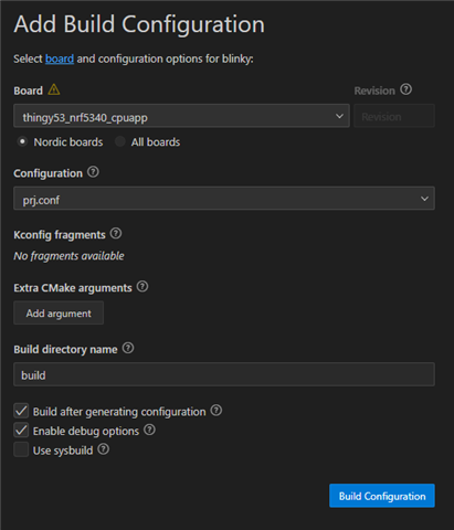

  • I had some time today to attempt your suggestions here is what I found. Apologies for the poorly formated posts the form wouldn't let me insert my logs as code so I had to put them directly into the message. Let me know if there is anything more I can upload to help troubleshoot this.
    Summary of Results:
    It appears that v2.4.0 fails for me when the network core is involved, BLE is utilized, or if I compile for the "_ns" version of the target hardware.
    • blinky - thingy53_nrf5340_cpuapp = pass
    • blink - thingy53_nrf5340_cpuapp_ns = fail
    • beacon - thingy53_nf5340_cpuapp = fail
    Notes:
    • Programming with the "zephyr.hex" did not work. I think you meant the "merged_domains.hex" file.
      • According to build outputs description the merged_domains.hex contains both the complete application core and the complete network core hex files.

    Blinky (PASS):
    • Copied the "blinky" example from `C:\ncs\v2.4.0\zephyr\samples\basic\blinky` to the folder `C:\Users\zach\Documents\repositories\nrf\blinky`
    • Opened and configured with VSCode
    • I built the blinky code using the nRF Conenct extension in VSCode and then flashed the board.
