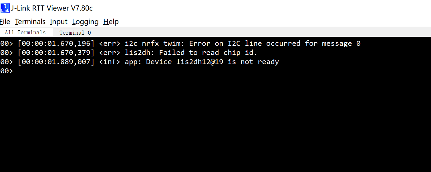

use the example project of lis2dh on ncs,the pin configuration of the i2c is correct,but it's can't to initialize,as follows:
Is there anything else need to configure

psencao said:only use the lis2dh application,can't Initial start with no log,add the lis2dh device to beacon application,found the i2c error.
Can you clarify if the standard unmodified LIS2DH sample works on your board? This means without merging it with the beacon sample?
Have you modified the pins that are used in the sample, if so what pins are you using?

it's also Unable to initialize:
The pins of both sda and scl have no signal change and keep low level
Ok, so you're not able to run the unmodified lis2dh sample on your board?
Have you checked the log? What error message do you get?

where is the debug log?this is the error message:
Have you modified the pins that the sample is using? Can you share the schematic of the module that you're using?
