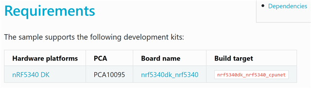

    You can see from the sample description that it's meant to be built for netcore, but I am surprised how you get errors. Could you try deleting all previous builds and try building a fresh one? Please try for netcore this time again.
