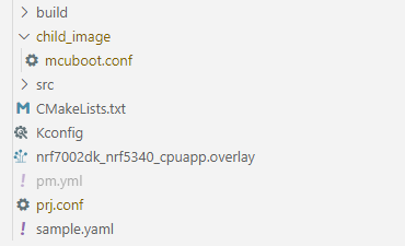

  • Hi Sigurd,
    I have tried your proposal, but I am still facing some issues. My setup is as follows:
    child_image/mcuboot.conf file:
    CONFIG_PM_PARITITON_SIZE_MCUBOOT=0x10000
    From Multi Image builds docs, you only need to name it like this, and the build system will automatically find it.
    So no need to make changes to CMakeLists.txt
    When adding CONFIG_BOOTLOADER_MCUBOOT to your project configuration, ncs/bootloader/mcuboot/boot/zephyr/ will automatically be added as your bootloader child image.

  • Hi Sigurd,
    Thank you for your answer and for the useful samples. I think I reached to build the app without flash overflow errors, but now, I get a compilation error related to the flash IDs. I think it might be because of using the external flash to store the MCUBOOT_SECONDARY partition. Is there any configuration am I missing?
    prj.conf file:

    mcuboot.conf file:
    CONFIG_NORDIC_QSPI_NOR=y
    CONFIG_BOOT_MAX_IMG_SECTORS=256
    CONFIG_PM_PARTITION_SIZE_MCUBOOT=0x10000
    Build log on this link
    Thank you,
    Candela
  • You need to have an mcuboot.overlay, same as you have an oberlay for the board to enable external flash.
    See this unofficial sample.
