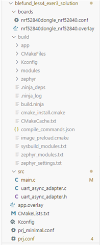

  • Thanks Simon,
    I am using Visual Studio for the development, and can't find reference to these settings.
    Here is a screen shot of the files I have access to in the project.
    Best Regards
    Paul
