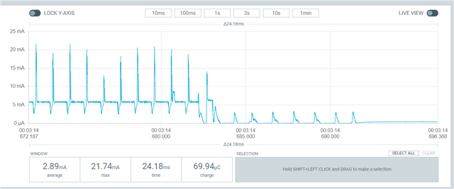

  • The problem is that after a long period of time, the scan stops even though bt_le_scan_stop() has not been called.
    that the scan stopped
    1. advertising report is not called
    2. When measuring the current consumption with PPK, the current consumption suddenly drops.
    confirmed by.

    You say the current consumption suddenly drops. How much exactly? Could it be that the RX device is going to sleep for some reason. I don't really see a reason why by reviewing your project though...

    Upload the PPK log when reception stops on the RX side.

    Can you also show me how the DK and PPK you're measuring on are connected physically, and if you're testing in source meter or ampere meter mode.
