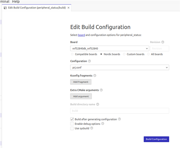

    I think it is necessary for me to explain the download process and confirm if I am missing any steps:
    1. Vs code “Open an exiting application”, to select "“Bluetooth: Peripheral Status”"
    2. Add the RTT enable command to the file prj.conf:
    # Reduce application size
    CONFIG_USE_SEGGER_RTT=y
    CONFIG_RTT_CONSOLE=y
    CONFIG_UART_CONSOLE=n

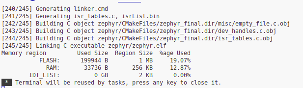

    3. "Edit Build configuration" ,and build
    1.
    4
    4. "Flash"and “Connect RTT”

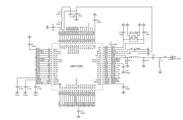

  • Hi, please allow me to update again.
    I have successfully connected, but I don't understand why I am doing this:
    I referred to the link: nRF5340 Peripheral BLE connections always fail with reason 0x3e (62)
    I have added the following content to prjconf:
    CONFIG_SOC_ENABLE_LFXO=n
    Bluetooth example successfully connected, I will add
    this content to the subject, Light_ Blub;
    The connection was also successful!
    I can check the customer board on the border router。
    The following is the distribution network information.
    Was it successful?
    Could you briefly explain the reason to me?

    Glad to hear that you feel you're progressing! I see that you've had some success here, but just a few questions from so I am on the same page as you.
    1. Were you able to flash a Bluetooth sample on the the E73-2G4M08S1C module, for instance the peripheral_uart sample? Where you able to connect with the nRF Connect application for either Android or iOS?
    2. Have you implemented all of the changes since my previous reply on a 52840DK, which the images you've posted suggest, or is it on the E73 module?
    3. I will see if I find some more information regarding CONFIG_CLOCK_CONTROL_NRF_K32SRC_RC. I see that in the original case they were using NCS v1.7.0, which is 2 years old, so this feature request may have been implemented in newer NCS versions. Based on what you describe, it looks like it may still be required. I will investigate the status on this request.

    thank you for your help.
    At present, my tests are all performed on E73-2G4M08S1C (I don't have nRF52840DK).
    The schematic diagram is very simple: we use 3.3V to supply power to E73-2G4M08S1C, and lead out Reset, GND, SWDIO, SWCLK for flash programs; in addition, Reset (p0.18) pin connects a capacitor (104) to GND; XL1, XL2 are not connected to 32K crystal oscillator, XC1, XC2 are connected to 32M crystal oscillator;
    Reply:
    I am using the matter example (Light_Blub), I just added: CONFIG_CLOCK_CONTROL_NRF_K32SRC_RC=y
    No other modifications are made.

    Reply:
    CONFIG_CLOCK_CONTROL_NRF_K32SRC_RC, does this configuration enable the internal crystal oscillator?
    My XL1 and XL2 are not connected to a crystal oscillator

  • Thank you for clarifying. In step 4 in your previous reply where you added an image showing the flash button there was a 52840DK listed, which caused some confusion to me.
    CONFIG_CLOCK_CONTROL_NRF_K32SRC_RC=y enables the LFRC instead of LFXO. I suspect that the E73 module does not have an LFXO or that there are some issues with a capacitor/it's missing a capacitor
    Disconnect reason 0x3e is a typical sign that this is the issue, caused by issues with the LF clock since you will not be able to send and receive packs at the correct timings. This leads to the loss of connection
