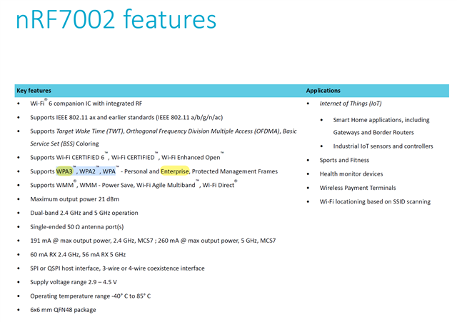

Is the 7002 support wpa-enterprise? What EAP methods are supported? Is there have example to guide use wpa-enterprise in NCS2.4.0?

I checked the nRF7002 specification found the similar infomation as above. Is this funciton a sdk function or hardware characteristics? I appriciate your support.

The WPA-Enterprise support is now avaliable on nRF Connect SDK v3.0.0.
You can read the following guidence to do test.
nRF70 Series advanced security modes
