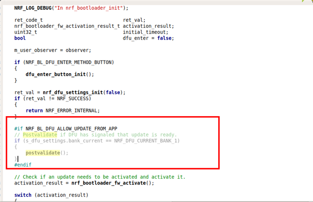

    There were some improvements and bug fixes made to the background DFU support in nRF5 SDK v.15.3.0. Therefore, I recommend updating to v15.3.0 if possible.
    From the SDK 15.3.0 release notes:
    ** DFU **
    - Various security improvements and fixes.
    - Fixed various bugs in background DFU.
    - Fixed bugs that appeared when combining transports (for example, UART + BLE).
    The main change was that updates staged by the application would be validated by the bootloader before activation. With this modification, it's not strictly necessary for the application to validate the update since the bootloader will handle it.
    The postvalidation() function shown below from v15.3.0 uses the init command stored to the settings page by the application to verify the update before activating it (i.e., copying the image from bank 1 to bank 0).
    Relevant DevZone post:  RE: App-based DFU, changing bank#1 address?
    Vidar

  • Hi Edwin,
    I believe you've listed the necessary steps. Just remember to set .bank_current = NRF_DFU_CURRENT_BANK_1 in the settings page before resetting to signal to the bootloader that there's a new image in bank 1.
    Vidar
