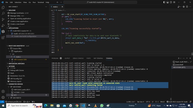

Found valid connection in connected state
Hope you are doing good!
I am using two nrf52833DK's one as a Central and the other as a Peripheral. I am also using another custom board (nrf52833) as a second peripheral.
NCS 2.2.0 for multi NUS central and 2.3.0 for peripheral_uart
Multi-NUS (github.com/.../multi-NUS), working fine.Able to connect the two peripherals.can send and receive data. Now issues i am facing are the following.
  1. When I connect and disconnect the peripheral and connect again(repeating this step every 20 secs), the following message on RTT [00:19:51.936,981] central_uart: ATT error code: 0x20011C0C
    [00:19:56.497,711] bt_conn: Found valid connection in the connected state
    [00:19:56.507,873] bt_conn: Found valid connection in the connected state
    [00:19:56.507,873] central_uart: Connecting failed
    [00:19:59.988,037] central_uart: Disconnected: E8:2B:FD:17:14:C2 (random) (reason 8)
    [00:20:25.330,444] central_uart: Disconnected: F7:13:07:67:2D:04 (random) (reason 8)

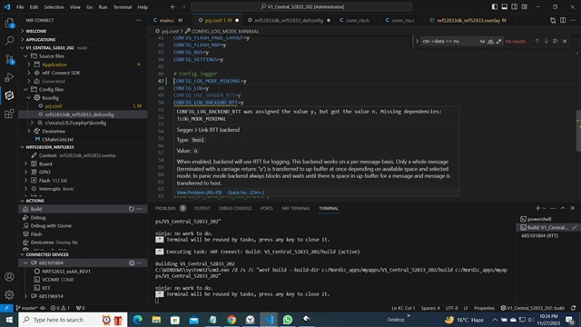

  2. Central (Multi-NUS) becomes unresponsive. So peripheral reset has no impact on it. Need to reset the central.
    I followed the https://github.com/NordicMatt/multi-NUS/issues/1 but still the same issue as discussed.

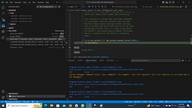

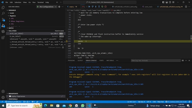

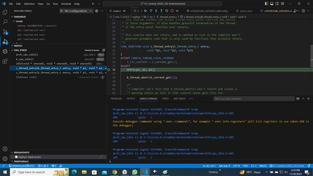

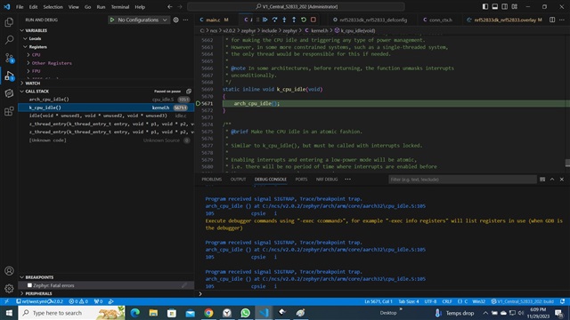

        3. I observed the same that after
            err = bt_conn_ctx_free(&conns_ctx_lib, conn);  // code added
            Multi-NUS unresponsive

prj.conf
# Copyright (c) 2018 Nordic Semiconductor
CONFIG_SPI=y
CONFIG_SPI_NRFX=y
# Enable the UART driver
CONFIG_UART_ASYNC_API=y
CONFIG_NRFX_UARTE0=y
CONFIG_SERIAL=y
CONFIG_CONSOLE=y
CONFIG_UART_CONSOLE=y
# Enable the BLE stack with GATT Client configuration
CONFIG_BT=y
CONFIG_BT_CENTRAL=y
CONFIG_BT_SMP=y
CONFIG_BT_GATT_CLIENT=y
CONFIG_BT_MAX_CONN=20
CONFIG_BT_MAX_PAIRED=20
CONFIG_BT_CONN_CTX=y
# Enable the BLE modules from NCS
CONFIG_BT_NUS_CLIENT=y
CONFIG_BT_SCAN=y
CONFIG_BT_SCAN_FILTER_ENABLE=y
CONFIG_BT_SCAN_UUID_CNT=1
CONFIG_BT_GATT_DM=y
CONFIG_HEAP_MEM_POOL_SIZE=2048
# This example requires more workqueue stack
# Enable bonding
CONFIG_BT_SETTINGS=y
CONFIG_FLASH=y
CONFIG_FLASH_PAGE_LAYOUT=y
CONFIG_FLASH_MAP=y
CONFIG_NVS=y
CONFIG_SETTINGS=y
# Config logger
CONFIG_LOG=y
CONFIG_USE_SEGGER_RTT=y
CONFIG_LOG_BACKEND_RTT=y
CONFIG_LOG_BACKEND_UART=n
CONFIG_ASSERT=y
CONFIG_BT_EXT_ADV=y
CONFIG_BT_CTLR_PHY_CODED=y
CONFIG_BT_USER_PHY_UPDATE=y
CONFIG_BT_SCAN_NAME_CNT=1
#CONFIG_BT_USER_DATA_LEN_UPDATE=y
#CONFIG_BT_AUTO_DATA_LEN_UPDATE=y
#CONFIG_BT_L2CAP_TX_MTU=247
#CONFIG_BT_BUF_ACL_TX_SIZE=251
#CONFIG_BT_BUF_ACL_RX_SIZE=251
#CONFIG_BT_CTLR_DATA_LENGTH_MAX=251

    I tried to add the log info for the configuration:
    CONFIG_LOG_MODE_IMMEDIATE
    SEGGER J-Link V7.88j - Real time terminal output
    SEGGER J-Link (unknown) V1.0, SN=685101804
    Process: JLink.exe
    [00:00:00.013,702] <inf> fs_nvs: 6 Sectors of 4096 bytes
    [00:00:00.014,099] <inf> fs_nvs: alloc wra: 0, fd0
    [00:00:00.014,434] <inf> fs_nvs: data wra: 0, 1c
    [00:00:00.014,892] <inf> sdc_hci_driver: SoftDevice Controller build revision:
                                             33 78 2a 18 20 f5 61 61  a6 8b 77 60 62 83 39 2a |3x*. .aa ..w`b.9*
                                             7c f1 14 e4                                      ||...
    [00:00:00.026,214] <inf> bt_hci_core: No ID address. App must call settings_load()
    [00:00:00.026,611] <inf> central_uart: Bluetooth initialized
    [00:00:00.029,541] <dbg> central_uart: uart_cb: UART_RX_BUF_REQUEST
    [00:00:00.030,029] <inf> central_uart: NUS Client module initialized
    [00:00:00.245,971] <inf> central_uart: Scanning successfully started
    [00:00:02.577,453] <wrn> central_uart: Connecting failed
    [00:00:02.673,248] <inf> central_uart: MTU (0): 23
    [00:00[00:00:29.574,523] <inf> central_uart: Disconnected...: E8:2B:FD:17:14:C2 (random) (reason 8)
    [00:00:29.575,378] <inf> central_uart: disconnected(): 0x20001cf0
    [00:00:29.753,204] <wrn> central_uart: Connecting failed
    [00:00:29.847,717] <inf> central_uart: MTU (0): 23
    [00:00:29.848,480] <inf> central_uart: mtu_exchange: 0x20001cf0
    [00:00:29.849,182] <inf> central_uart: Exchange pending...
    [00:00:29.849,792] <inf> central_uart: Connected: E8:2B:FD:17:14:C2 (random)
    [00:00:29.852,020] <inf> central_uart: connected(): 0x20001cf0
    [00:00:29.852,630] <inf> central_uart: connected()_nus_client: 0x200113ac
    [00:00:29.853,332] <inf> central_uart: NUS Client module initialized
    [00:00:29.854,064] <inf> central_uart: gatt_discover(): 0x20001cf0
    [00:00:29.854,675] <inf> central_uart: connected()_nus_client: 0x200113ac
    [00:00:29.950,439] <inf> central_uart: MTU exchange 0 successful (65)
    [00:00:29.951,141] <inf> central_uart: mtu_exchange_cb: 0x20001cf0
    [00:00:30.747,985] <inf> central_uart: Service discovery completed
    [00:00:30.752,502] <inf> central_uart: Scanning started
    [00:00:30.753,112] <inf> central_uart: ctx->data == nus , nus 0x200113ac
    [00:00:30.753,814] <inf> central_uart: ctx->data == nus , i   0
    [00:00:30.754,516] <inf> central_uart: Sent to server 0: 0
    [00:00:30.998,077] <wrn> central_uart: ATT error code: 0x200113AC
    [00:01:42.248,962] <inf> central_uart: Disconnected...: E8:2B:FD:17:14:C2 (random) (reason 8)
    [00:01:42.249,786] <inf> central_uart: disconnected(): 0x20001cf0
    [00:01:42.482,666] <wrn> central_uart: Connecting failed
    [00:01:42.574,798] <inf> central_uart: MTU (0): 23
    [00:01:42.575,561] <inf> central_uart: mtu_exchange: 0x20001cf0
    [00:01:42.576,202] <inf> central_uart: Exchange pending...
    [00:01:42.576,812] <inf> central_uart: Connected: E8:2B:FD:17:14:C2 (random)
    [00:01:42.579,132] <inf> central_uart: connected(): 0x20001cf0
    [00:01:42.579,742] <inf> central_uart: connected()_nus_client: 0x200113ac
    [00:01:42.580,444] <inf> central_uart: NUS Client module initialized
    [00:01:42.581,176] <inf> central_uart: gatt_discover(): 0x20001cf0
    [00:01:42.581,817] <inf> central_uart: connected()_nus_client: 0x200113ac
    [00:01:42.677,551] <inf> central_uart: MTU exchange 0 successful (65)
    [00:01:42.678,192] <inf> central_uart: mtu_exchange_cb: 0x20001cf0
    [00:01:43.475,097] <inf> central_uart: Service discovery completed
    [00:01:43.479,583] <inf> central_uart: Scanning started
    [00:01:43.480,163] <inf> central_uart: ctx->data == nus , nus 0x200113ac
    [00:01:43.480,804] <inf> central_uart: ctx->data == nus , i   0
    [00:01:43.481,506] <inf> central_uart: Sent to server 0: 0
    [00:01:43.725,189] <wrn> central_uart: ATT error code: 0x200113AC
    [00:01:47.101,989] <wrn> bt_conn: Found valid connection in connected state
    [00:01:47.113,128] <wrn> bt_conn: Found valid connection in connected state
    [00:01:47.113,769] <wrn> central_uart: Connecting failed
    [00:01:50.676,055] <inf> central_uart: Disconnected...: E8:2B:FD:17:14:C2 (random) (reason 8)
    [00:01:50.676,818] <inf> central_uart: disconnected(): 0x20001cf0
    at this point central became unresponsive

    static void connected(struct bt_conn *conn, uint8_t conn_err)
    	int err;
        struct bt_nus_client_init_param init = {   // code added
    		.cb = {
    			.received = ble_data_received,
    			.sent = ble_data_sent,
    	if (conn_err) {
    		LOG_INF("Failed to connect to %s (%d)", log_strdup(addr),
    			conn_err);
    			printk("Failed to connect to %s (%d)", log_strdup(addr),
    			conn_err);
    		if (default_conn == conn) {
    			bt_conn_unref(default_conn);
    			default_conn = NULL;
    			err = bt_scan_start(BT_SCAN_TYPE_SCAN_ACTIVE);
    			if (err) {
    				LOG_ERR("Scanning failed to start (err %d)",
    					err);
    					printk("Scanning failed to start (err %d)",
    					err);
    		return;
    	mtu_exchange(default_conn);
    	LOG_INF("Connected: %s", log_strdup(addr));
    	num++;
        printf("Connected.... ");
    	// code added
    	/*Allocate memory for this connection using the connection context library. For reference,
    	this code was taken from hids.c
    	struct bt_nus_client *nus_client = bt_conn_ctx_alloc(&conns_ctx_lib, conn);
    	if (!nus_client) {
    		LOG_WRN("There is no free memory to "
    			"allocate the connection context");
    	memset(nus_client, 0, bt_conn_ctx_block_size_get(&conns_ctx_lib));
    	err = bt_nus_client_init(nus_client, &init);
    	bt_conn_ctx_release(&conns_ctx_lib, (void *)nus_client);
        LOG_INF("connected(): %p", (void *)conn);
    	LOG_INF("connected()_nus_client: %p", (void *)nus_client);
    	if (err) {
    		LOG_ERR("NUS Client initialization failed (err %d)", err);
    	}else{
    		LOG_INF("NUS Client module initialized");
    	gatt_discover(conn);
    	static struct bt_gatt_exchange_params exchange_params;
    	exchange_params.func = exchange_func;
    	err = bt_gatt_exchange_mtu(conn, &exchange_params);
    	if (err) {
    		LOG_WRN("MTU exchange failed (err %d)", err);
    	err = bt_conn_set_security(conn, BT_SECURITY_L2);
    	if (err) {
    		LOG_WRN("Failed to set security: %d", err);
    	err = bt_scan_stop();
    	if ((!err) && (err != -EALREADY)) {
    		LOG_ERR("Stop LE scan failed (err %d)", err);
    static void disconnected(struct bt_conn *conn, uint8_t reason)
    Muhammad,
    You should start the central in the debugger and repeat the steps it until it becomes unresponsive and halt the debugger (halt it but do not stop the debugger). As soon as you halt/pause the debugger, the IDE will tell you the instruction it was executing before the halt. It will give you context of the logic which the central was executing in this unresponsive state. You need to give us this context to understand where the central got stuck or if it was idling.
  • Hi Susheel Nuguru!
    Thank you so much for the response!
    I followed your instructions and after unresponsive central I paused the debugger and it stuck at the following code.
    Thanks & Regards,
    Muhammad Usman
  • Muhammad,
    The central does not seem to be unresponsive. It just went into idle mode since it thinks that there is nothing else to process.
    Is the scanner active at this state? Are you starting the scanner after the disconnect callback?
