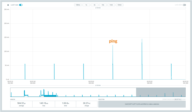

I am using the nRF7002DK development board, which features an nRF5340 as the Host MCU for the nRF7002 chip. I am testing the "Wi-Fi TWT Sample" sample project, which allows me to establish a Target Wake Time (TWT) session between the nRF7002 Wi-Fi module and a Wi-Fi 6 Access Point.
In this particular case, I have configured a TWT interval of 5 seconds. During the time interval between two TWT pings, it is observed that the nRF7002 is in Sleep Mode with a consumption of 18uA, as indicated in its datasheet and the image shown below:
nRF7002 Consumption
However, for my development project, it is a requirement that, between two TWT pings, the nRF5340 Host MCU maintains an average current lower than that presented in the following image (currently at 158uA).
nRF5340 Consumption
Could you please guide me on any configuration settings for the nRF5340, either in its QSPI interface or its Sleep modes, to reduce the average current consumed by this MCU between TWT intervals?

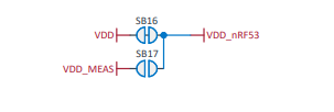

    - Solder bridges SB16 is open and SB17 is short in order for the nRF5340 to be powered by net VDD_MEAS, as described in Using two PPK2s to measure component current consumption

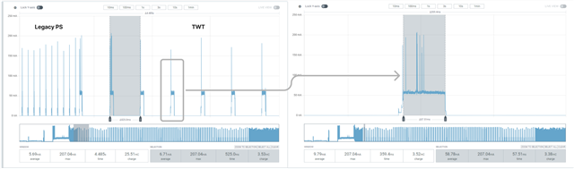

    Here is a screenshot of the test, and here is one comparing legacy PS and TWT. What does the log from your nRF7002 look like? Something about your power draw makes me think that you're maybe not getting TWT.
    I'll find a way to test this myself next week, but I don't have access to a router that supports TWT right now.

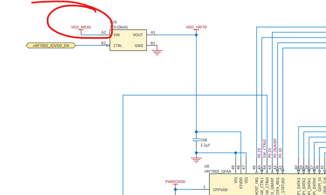

    That is interesting. I am not familiar with this myself. Are you then showing me the power consumption of just one of chips here?
    No, that's quite the opposite. In the default (stock) configuration, SB16 is closed and SB17 is open, which implies that the nRF5340 SoC is powered from the VDD net directly as show here:
    Current measurements at pin P22 in that solderbridge configuration won't take into account consumption from the SoC, only IOVDD for the nRF7002 because it is powered through the VDD_MEAS net as shown here:
    By reconfiguring solder bridges so that SB16 is open and SB17 is closed, both the current to the nRF5340 SoC and to the nRF7002 IC (IOVDD net) flows through the VDD_MEAS net and is thus measurable on pin P22. That is the configuration my board was in for the results I reported to you in my post, meaning that it corresponds to the combined consumption of both chips.

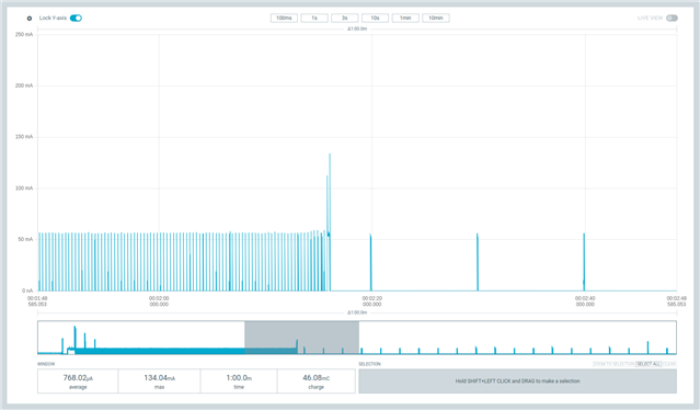

    As you can see, TWT is established and we get a TWT setup success. My TWT interval and TWT wake interval is different from yours because I am working with default parameters from the sample Wi-Fi: TWT and you are referring to results from NCS_examples/wifi/twt_provisioning_demo at main · martelmy/NCS_examples · GitHub. In my sample, those values are 65 ms for the wake interval and 524 ms for the TWT interval, which makes sense with the negotiated values and also with what I measure on the VBAT net of my board (pin P23, see the following image). In your case, the TWT interval was set to 10 s.
    Also, I might add that my issue is with consumption from the nRF5340 host and not from the companion IC nRF7002. Therefore, measurements at VDD (pin P22) would be preferable over measurements at VBAT (pin P23). If you find the time to test the consumption at VDD and report it here I would be very grateful.
