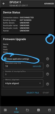

As the title suggests, is this a specification? or bug? otherwise something missing in the settings?
NVS values did not vanished while nRF5 SDK used.
before DFU
after DFU

Where do you store the values? Is it in NVS?
If you're doing DFU from nRF Connect Device Manager app, there's a setting "erase application storage", enabled by default.
Could you check that?

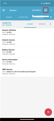

I am using the nRF Connect for mobile app. is it common to use the nRF Connect Device Manager app?
By the way, is there a setting equivalent to that function in nRF Connect for mobile?
If you are using the nRF Connect app, there is an equivalent settings in Settings/Mcu Manager options/Erase application settings.
Could you please check if that is the cause?
If it doesn't help. Could you try to set CONFIG_IMG_ERASE_PROGRESSIVELY to see if it differs from this?
