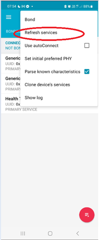

  • I appreciate your suggestion and I will go through the course but that is not the point. I am interested in debugging this issue as I am convinced that this is a bug and there should not be HTS service in my simple BLE example code. I dont know whole lot about BLE but I know enough to understand that this is not how it supposed to work.
    Instead of suggesting various things, why dont you take a minute to try this out yourself and you will recreate the issue and realize that this should not happen.
  • I was wrong, HTS is actually its own source file in the example code (hts.c in src directory) and not activated via Kconfig nor device tree.
    Double check that this file is not actually present in your code - it does not need any calls from main() to be active.
    Some devices can cache device discovery data. NRF connect has a "Refresh services" menu option that should read service definitions fresh from the device.
  • Are you referrng to this:
    If yes, that did not do anything.

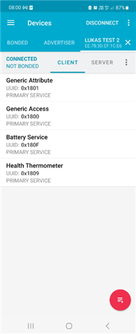

    Experiment #2
    To test if I can add new services, I have added the following to my code:
    static const struct bt_data ad[] = {
    	BT_DATA_BYTES(BT_DATA_FLAGS, (BT_LE_AD_GENERAL | BT_LE_AD_NO_BREDR)),
    	BT_DATA_BYTES(BT_DATA_UUID16_ALL, BT_UUID_16_ENCODE(BT_UUID_BAS_VAL))};
    and in my prj.conf I have enabled:
    CONFIG_BT_BAS=y
    After flashing the device and opening nRF Connect on my mobile phone, I see the new Battery Service appear but Health Thermometer still persists:
    I have also tried on multiple phones and all phones provided same results.
    The experiment above proves that:
    • nRF52 device is capable of adding new service (Just like I added Battery Service)
    • There is still no logical explanation on why the Health Thermometer service appears
    • The issue regarding Health Thermometer persists on different devices (multiple phones).
    I am really hoping that we can get to the bottom of this as this is really frustrating.
  • Look at the actual project files in the src folder, I bet there is a hts.c in there.
  • You are totally right. I had hts.c file in my project and that had an effect (even though no functions were called.
    Not going to lie, this must be the dumbest thing I have seen in my programming experience. Just by having .c file in your project without any function calls there was a automatically a BLE service added. This person who wrote this code should be sent to prison.
    Thank you for helping me out.
