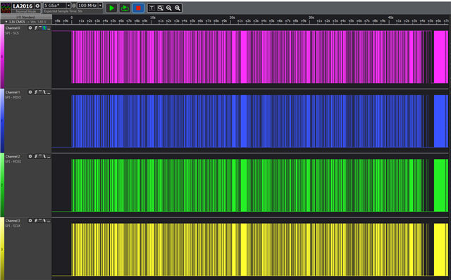

    I don't see an error message that would indicate why it's failing.
    I tried turning on logging in mcuboot.conf but it doesn't seem to print anything. Is there a way to see what mcuboot is doing and why the image swap is not happening?
    My mcuboot.conf is below. I had to increase the size of the bootloader because it kept exceeding the flash memory. My custom board is limited to RTT debuggin (no serial pins exposed)

    I'm not seeing any external flash errors and there's certainly activity when I examine the lines using a logic analyzer:
    Do you have any suggestions on what to try? I suspect mcuboot is rejecting the image for some reason. How do I prove this?

    V	10:17:14.181	[McuMgr] Uploading firmware...
    A	10:17:52.144	[McuMgr] 201624 bytes sent in 37716 ms (5.35 kB/s)

    The error you see inside the nRF connect App is a bit generic; are you trying to add any custom services or characteristics to your project?
    How are you testing the firmware update? I mean, are you changing anything inside the application to see a visible change? For the debugging logs, have you configured the application? You need to include CONFIG_LOG=y and CONFIG_LOG_BACKEND_UART=y.
     <err> mcumgr_img_grp: Failed to open flash area ID 1: -2
    I have seen this error before; it says trying to open a flash area that doesn't exist, but as far as I remember, this should not stop the firmware update.
    Is this happening with the sample I shared, or have you changed anything inside the sample?
