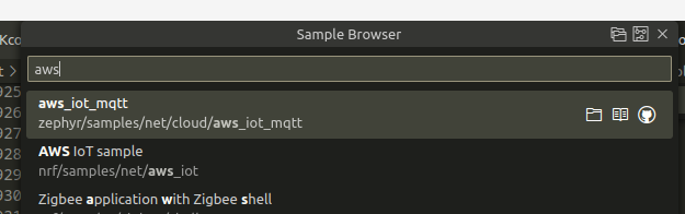

    Meanwhile, as I was browsing the code samples related to AWS I noticed that there is a new (at least to me) sample related to the subject matter:
    The one in the Zephyr samples tree. Do you think it might give me some hints about what's going on if I go and compare both samples?
    They use entirely different libraries, so I doubt it is very useful.
