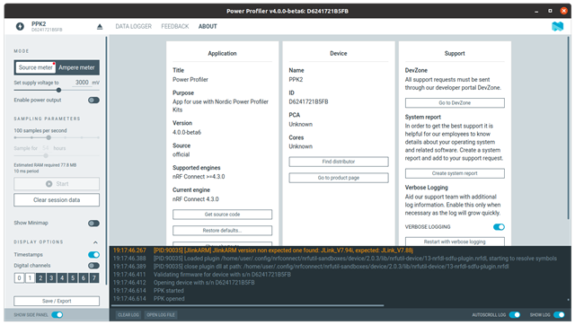

  • Hi Abhijith
    Thanks very much for your help. I've gathered some logs for what you suggested. I'm using the PowerProfiler version 4.4.0-beta6 which then updates the firmware inside the PPK. I do not know what version of the nRF command line tools, but it's the nrfConnect version nrfConnect-4.3.0-x86_64.appImage downloaded from Nordict website.  Segger tool version is 7.94i.
    Please see some other from attached screenshot
    The verbose log of a session that dies after 1 hour 33 mins is also attached. The length of the session varies from 1 hour 30 mins to 1 hour 45 mins. If I don't log the power usage (not clicking on the "Start" button to log the power data then the PPK2 won't get disconnected from the USB.  It would be able to supply power to my device under test for as long as half day. But if I start any logging, then it will die.  Hope you can find some clues from the log.  2024-02-12T22_37_17.072Z-log.txt
    By the way, I've had similar disconnects from different PC, different USB ports, different cables. Also another co-worker of mine also similar issues on his PPK2
    Thanks
    -Thanh
