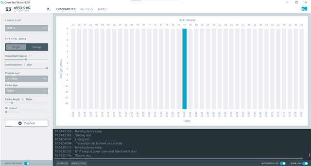

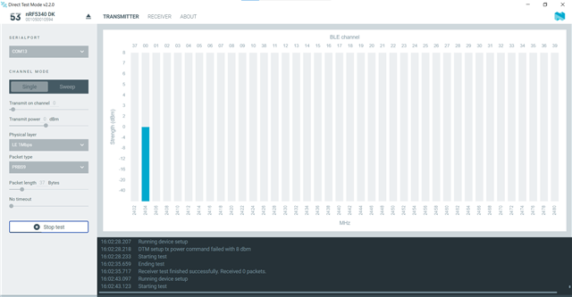

By flashing the DTM example I'm executing the TX and RX tests in the DTM tool like this,
But connecting the external antenna to a power meter and testing, I'm not seeing any power.
Do I need to make some modifications on the board to see the power on TX and RX tests?

Hi Runar,

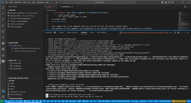

on trying to execute Radio Test Sample, I'm facing the below build error,
on using DTM as I said early, though the DTM in SDK is showing power in the UI, I'm not observing any power on the power meter, or these is o significant rise in current measured.
please help me carry out RF measurements.

I was not able to reproduce the error on a newer version of the sdk and toolchain v2.52. So I will see if I can reproduce it on an older version of the sdk(v2.3.0)

I'm flashing these example programs using vs code extension and trying to measure the output power at that point using a power meter, also I've connected an ammeter to VDD and VDD_HV points to measure current consumption at that time.
on flashing DTM example, though I'm seeing power on the GUI of DTM in nRF connect for Desktop, I'm not seeing any power measurement on the power meter and I'm not seeing any significant rise in current on the ammeters.
