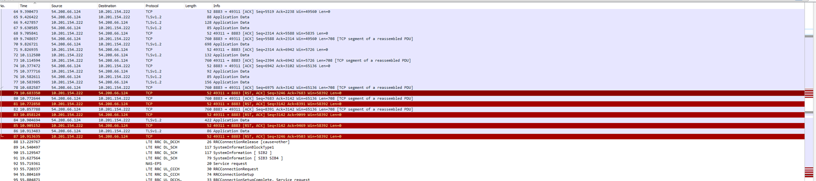

    Here is a trace from our custom firmware. I let it cycle through 2 attempts to connect nrfCloud. Now I don't know if I'm reding the trace correctly but in wireshark the largest TCP frame is 760 and the largest TLS frame is 758.  I think the issue is present in this trace but I don't know how to interpret it. It seems like the modem is requesting 5 separate times to rest the connection just before RRC release. Some help interrupting would be great.

  • Hi Eric,
    If you send what you pasted before, the JSON chunk is over 2300 bytes including whitespace.  The problem is the device subscribing to one of the shadow topics which RECEIVES a too big update. In the modem trace, the connection is closed because they receive too big TLS fragment. As I said, nRF9160 has limited resources reserved for TLS socket handling. This limitation has nothing to do with the nRF Cloud/AWS 8KB shadow size requirement. As long as the MQTT/TCP(TLS) from nRF Cloud to nRF9160 packet size is less than 2KB, it should be OK.
