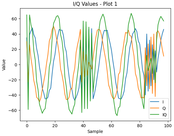

Hey,
I am trying to calculate distance between 2 BLE devices with nrf5340 by myself. i would have an initiator and a reflector. so my question is how can i configure my device as a reflector and how can i send CTE at different frequencies?
Thanke you
  • Hi
    Okay, so what you describe is basically Bluetooth channel sounding, which will not be supported on the nRF5340 I'm afraid, so we will not be able to provide any support for this, and you'll unfortunately be on your own if you want to implement something like this on an nRF5340.
    Simon
    Yes, I don't want any information about the Bluetooth channel Sounding. I only want to know how to send CTE on different carrier frequencies. I can see the channel index of the received CTE packet. I plot the I/Q data. The number of samples is 45, so my question is, does this mean that I can send a CTE request and get a CTE response from my TX with 45 I/Q samples? I am using the connectionless direct finding example.  How can I define my device as a reflector?
  • Hi
    I asked our expert on channel sounding/distance measurement (Carsten which was also the advisor on one of the papers you linked to), and he does not think this will be very viable on an nRF5340 I'm afraid. What you're asking for is not public I'm afraid, so I can't help you. It should be possible to do MCPD by sending CTE packets, but the results will not be very good either. Sorry that I'm being the bearer of bad news.
    Simon
    The result is not a problem, I just want to understand it and document it in my thesis. Can you tell me how I can configure a device as a Rx and Tx to get a "reflektor"?
