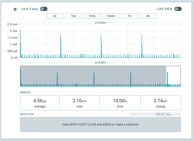

    It's taken a long time, but I finally got myself hold of a PPK2 and the measurements are looking much more reasonable:
    I think I can finally mark this as solved. I think to sum up the problems faced:
    1. My setting of SYNTH for the clock LFCLK. This caused the device never to sleep.
    2. The reason I needed SYNTH was that there was a hardware issue within the PCB design effecting the antenna which caused BLE not to be detectable using anything other than a configuration that caused the device to not be able to sleep (or otherwise be undetectable).
    3. Once 2. was resolved, I could set LFCLK to RC Oscillator and use the recommended settings for the LFCLK
    #define CLOCK_CONFIG_LF_SRC 0
    #define NRFX_CLOCK_CONFIG_LF_SRC 0
    #define NRF_SDH_CLOCK_LF_SRC 0
    #define NRF_SDH_CLOCK_LF_RC_CTIV 16
    #define NRF_SDH_CLOCK_LF_RC_TEMP_CTIV 2
    #define NRF_SDH_CLOCK_LF_ACCURACY 1
    4. The PPK1 was giving unreliable readings for power measurement meaning that the readings were showing some clearly erroneous results. Purchasing a PPK2 to test helped show the correct power reading, which averages:
    ~4.55uA
    Thank you for your patience with this - it's been quite an puzzle on my side. Thanks for baring with me during it, I really appreciate the support, it's been top quality.

    1. Yes, using the SYNTH for the LF clock source will cause the HF crystal to always be on and thus the device will never be in a low power state as is possible with the other clock sources.
