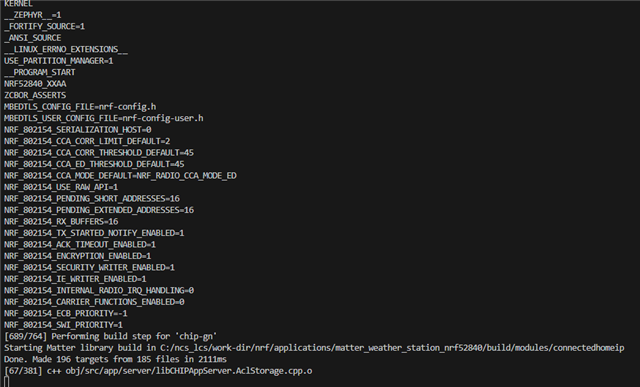

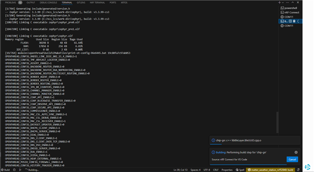

I am using nrf52840DK and trying to implement a weather station application using thingy53 application example.
I am using a Bosch BME280 sensor and could read the data from the using I2C.
Now I was integrating it into matter using same DK and BME280 sensor I have done all required changes for my application and tried to build but I got Issue with the RAM.
While build it says RAM overflow by some bytes as i have attached the image below I anyone faced this issue it will be helpful for my implementation.
I want to know do I need add some thing in config file or how can i build this in to flash.

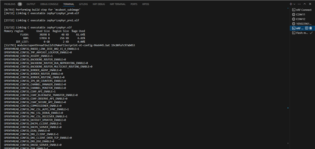

  • Hi Marte,
    I have tried using prj.conf and tried to optimise the footprint according to the guide you provided,.
    Still I could not connect using bluetooth.

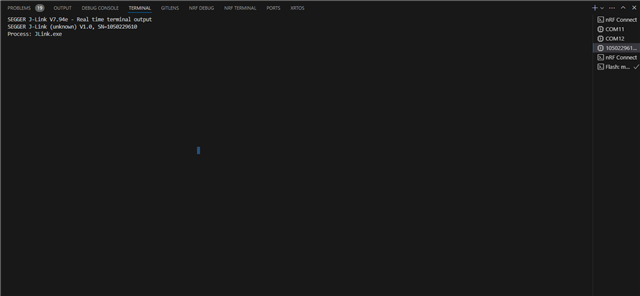

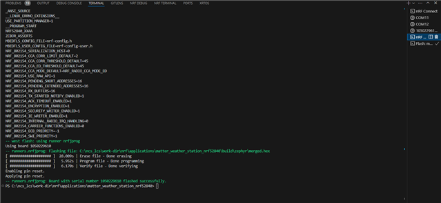

  • Hi marte,
    I don't see the device advertising.
    I have attached some of the files from build and what i see in the serial monitor.
    I could see everything build and flashing in the board but I don't see the device advertising or any thing on the serial terminal.
    Thanks & regards
    Rutwik

    And I dont see any thing on the serial monitor I am attaching what I am able to see through Com.
    I: Starting bootlader
    E: failed to openfalsh area ID 1
