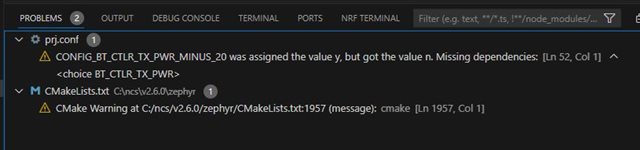

I was evaluating the throughput of NRF5340 using the DK. I would like to set the transmission power  under 0 dBm of the peripheral device.
However, i was unable to modify the default transmission power using kconfig or apis. I have gone though other posts citing the same, but either they are out dated or not completely useful for me.
Any help would be much appreciated.

  • Torbjørn,
    In the peripheral_uart example, I tried CONFIG_BT_CTLR_TX_PWR_MINUS_20=y with nrfConnect App. Did not see much of a difference in RSSI levels.
    Also see the warning log below. There was no hci_ipc.conf in peripheral_uart. Hope it is fine.
    Later we made the below changes in the throughput example and now we are seeing changes in TX power level.
    1. Added CONFIG_BT_CTLR_TX_PWR_MINUS_20=y in hci_ipc.conf
    2. Added CONFIG_BT_CTLR_TX_PWR_MINUS_20=y in prj.conf. ( Note: It worked without this change as well )
    regards,
    Vinu
  • Hi Vinu
    Essentially you need to create the child_image folder and the hci_ipc.conf file, if it doesn't exist already.
    You should remove the CONFIG_BT_CTLR_TX_PWR_MINUS_20 config from prj.conf. Since the Bluetooth controller resides entirely in the network core the controller related configurations don't apply to the application core (prj.conf is for the application core only), and if you include it you will get a warning like you discovered.
    Best regards
    Torbjørn
  • Yes, that is correct. We also needed changes only in hci_ipc.conf
    Thanks for the support, Torbjørn.
