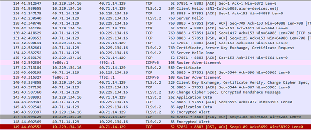

So it seems like the issue is with the device certificates. However, I followed the documentation multiple times 1:1 so it's weird. Here is what I've tried so far:
Here is a pastebin for the certification process (using nrfcredstore): https://pastebin.com/gx4Ahrcd
Any help would be appreciated
  • I'm not proficient with the TLS handshake but by reading a few articles it seems like it finishes the handshake and only after it fails. Unless I'm understanding it incorrectly.
    EDIT: I've now found that "Encrypted Alert" means "Decryption Failed" so I'm digging more into that
    Okay so that's indeed an issue with the certificates. The issue is figuring where it went wrong because I followed the docs a couple of times already. Is there some azure iot hub configuration that I should share?

  • I got it working. What I did was follow this tutorial from Microsoft again but this time, instead of using the device id (CN) like the tutorial from Nordic, I used device##. This means that the evaluation board is able to connect using certificates but following the official tutorial from Nordic didn't work. My guess is that the issue is with the CN, that nrfcredstore uses by default is invalid in some sort of way. In case it's different than the usual, for me it was something like: #####-####-########-### (not exact number of #'s) that instead of # there was a letter or a number. And somehow this string was either invalid as a CN or as a device name for Azure Iot Hub. Whatever it was, it's working now so this issue can be marked as resolved
