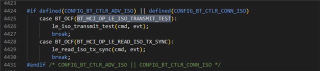

    I'm trying to use the Zephyr controller with the (CONFIG_BT_LL_SW_SPLIT=y) and (CONFIG_BT_CTLR_DTM_HCI=y), as you mentioned, to execute the DTM test. I changed the hci_rpmsg child image config file with these two flags. The code built successfully and I believe the code uses Zephyr controller now.
    The next step is to use the below HCI commands to execute the DTM testing:
    BT_HCI_OP_LE_ISO_TRANSMIT_TEST
    BT_HCI_OP_LE_ISO_RECEIVE_TEST
    BT_HCI_OP_LE_ISO_READ_TEST_COUNTERS
    BT_HCI_OP_LE_ISO_TEST_END
    - Are the above BT_HCI_OP.... flags related to DTM testing? or Am I missing something?
    If yes, when I call the above HCI commands, I get errors. When I checked the implementation of the hci_rpmsg code, I found that these HCI commands require different configurations than CONFIG_BT_CTLR_DTM_HCI and CONFIG_BT_LL_SW_SPLIT. The below screenshot is from hci.c file.
    At this point, I entered a continuous loop of configuration errors.
    is there an example of how to configure the hci_rpmsg correctly to support the Zephyr controller with these DTM HCI commands? also, is there an example of how to use them?
    These tests are not DTM related (this is for etsting LE isocnronous channels, while DTM is for PHY level testing).
    Regardign configurations, CONFIG_BT_CTLR_ADV_ISO or CONFIG_BT_CTLR_CONN_ISO is requiered in order to include most of this (you can see that in the code). I do not have any example of how to intergrade this in the hci_rpmsg.
