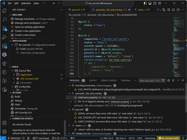

  • When I've tried that before I get the warning "Unknown property" as you can see from the screen shot. I thought that meant I was using the wrong statement.  I went through the yaml files to see what RTS and CTS were being called, but that didn't seem to help.  Is that warning of "Unknown property" a problem?
    I tend to ignore this "Problems" tab, because it gives a lot of false warnings. Does the build log say anything about being an unknown property if you use the /delete-property/ line?
