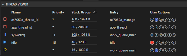

  • Hello  ,
    Here is a print of the threads' states at the moment the worker is called to handle interrupt off-load communications.
    The only thread preemption is sysworkq.
    Ricardo
    Elfving said:
    Strange that this is happening even when the threads are non-preemptive, though I agree that the other threads are probably the culprit here.
    I take this back; the threads running shouldn't make much of a difference. And 2.5ms is way too long.
    Ricardo Ferreira said:
    The sample at samples/boards/nrf/nrfx has zero latency, but as soon as I add a thread to manage communcations and a worker to handle interrupt, interrupt response goes almost to 3ms (although sometimes it instantaneous).
    Thanks for giving me a way to reproduce it. I'll try this myself later this week.
    Elfving
