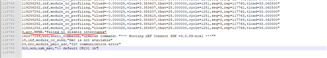

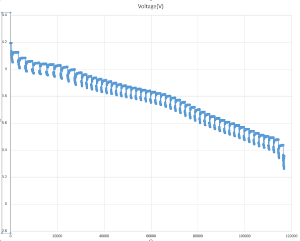

We decided to use the 802540 battery for our application with the nPM1300. To get a good estimate of the state of charge (SOC), we did the very lengthy battery profiling, which took us 2 days. The battery profiling was completed at night and then the PC went into hibernation. At the end of the profiling, a message popped up saying it could not process the data and there was a button to end the measurement. We clicked it and tried to finish the processing to get the model.inc file, but an error kept popping up. Is there anything we can do to complete the last step?
This is what the nPM PowerUp looks like:
We can see that there is the saved csv file with all the messdata. What else does he need to complete the processing?
Is there a good subset of available battery models from Nordic that we can use for the battery 802540 ?
