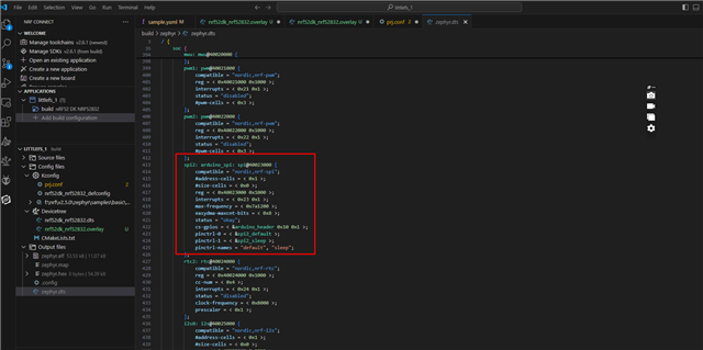

  • That is spi1, but in your below overlay, it looks like your configuration is connected to spi2?
  •  SPI2 status is also okay.
    Moreover I try SPI1 in the overlay as well. Still get the same issue.
  • Looks like maybe the overlay is not included in the build?
    Try to make an obvious error in the overlay file and see if that crashes the build?
  • I make a obvious error in the overlay.
    Change the compatible "nordic,nrf-spi" to 'jedec,spi-nor' .
    It crashes the build. I am attaching the error massage here.

  • I tried on my end.
    To build the hello world sample with the overlay and prj.conf you supplied earlier in this ticket. Building for nrf52dk_nrf52832.
    And it builds without error on my side.
    Do you see the same if you do this with the hello world sample?
