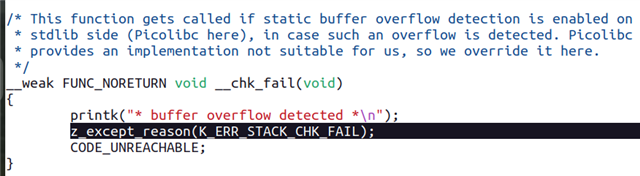

I'm working with nRF Connect SDK (Zephyr). In that I am using 255 byte array to get response from nrf52832 through BLE. my code is getting crash in response back. when I decrease size of array to 50 byte it's working.
but when I compile same in nrf5 sdk code it's working properly with 255 bytes array. Can you provide any solution or workaround to get it work?

[00:00:06.946,380] <err> MCP7940N: read_time: RC = 0
localtime_buff = Thu 2024-08-29 19:27:49
[00:00:07.946,685] <err> MCP7940N: read_time: RC = -5
[00:00:07.946,685] <err> adc_module: sec_timer_handler: Failed to read time, error: 251
[00:00:08.000,549] <err> os: mem_manage_fault: ***** MPU FAULT *****
[00:00:08.000,549] <err> os: mem_manage_fault:   Data Access Violation
[00:00:08.000,579] <err> os: mem_manage_fault:   MMFAR Address: 0x0
[00:00:08.000,579] <err> os: esf_dump: r0/a1:  0x20002bb0  r1/a2:  0x00000000  r2/a3:  0x00000000
[00:00:08.000,610] <err> os: esf_dump: r3/a4:  0x00000000 r12/ip:  0x00000000 r14/lr:  0x0002130b
[00:00:08.000,610] <err> os: esf_dump:  xpsr:  0x21000221
[00:00:08.000,640] <err> os: esf_dump: Faulting instruction address (r15/pc): 0x000211a2
[00:00:08.000,671] <err> os: z_fatal_error: >>> ZEPHYR FATAL ERROR 19: Unknown error on CPU 0
[00:00:08.000,671] <err> os: z_fatal_error: Fault during interrupt handling
[00:00:08.000,732] <err> os: z_fatal_error: Current thread: 0x20001a78 (unknown)
[00:00:08.439,880] <err> fatal_error: k_sys_fatal_error_handler: Resetting system
