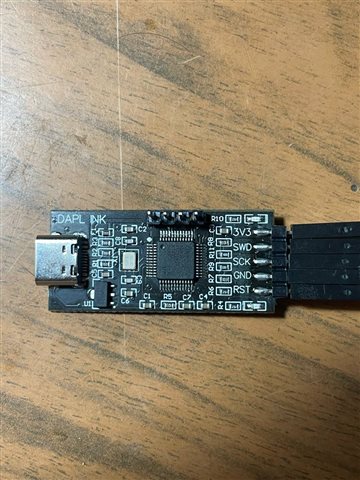

I haven't found any discussions on this topic yet. I'm trying to flash my nRF52840 custom board, which I bought on AliExpress. It's named "nRF52840 SuperMini, Nice!Nano compatible." I attempted to flash it in VS Code using the nRF Connect extensions, but the flashing failed due to the UF2 bootloader (I saw that some people use Virtual COM for flashing).

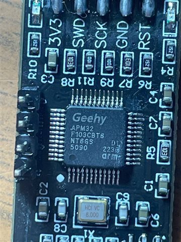

I also bought a CMSIS-DAPLink programmer from AliExpress (the one with the USB option). Unfortunately, I bricked it, but I managed to restore it using custom firmware for ST-LINK V2. However, the LED is no longer blinking, and while the nRF Connect Programmer detects my DAPLink, it says, "No operations possible for device. If the device is an MCUboot device, make sure it is in bootloader mode."
Double-tapping RST to GND doesn't put it in DFU mode; it just resets, and the UF2 content folder appears. I've tried to find other bootloaders for DAPLink or this nRF board, but haven't had any success.
