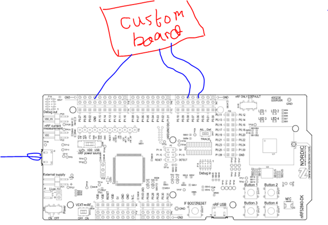

  • lx_brz said:
    Sorry, I don't understand how this is supposed to help, maybe there is a misunderstanding somewhere?
    Yeah sorry about that. As well as for how long it took for you to get a reply here. I guess I meant uart.
    Flash DTM to your custom board. Then you can for instance connect the uart pins of the nrf52840DK you have, to whichever uart pins you use on your custom board. I just tried this myself with two '840DKs and it worked fine.
    Just erase the nRF on the DK (with eg. nrfjprog --recover) to make sure that you are communicating with the correct nRF. The DTM app might prompt you to reflash the DK, but you can just decline that and it should still work.
