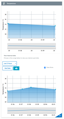

  • All cards, custom and standard, only show data that arrives after you started your current session with nrfcloud.com. If you navigate to a different page within nrfcloud.com and come back to a device's page, you see the same graphs with the same data. But if you close the browser (or the nrfcloud window or tab), and then re-open it, it will only show data after that point.
    However, you can always retrieve recent historical data by selecting the blue clock-arrow icon at the lower right of a card, such as your custom card. There you can select a time range and view the graph of that data, or see the map of stored locations. Locations are stored for 6 months, all other messages are stored for 30 days. Example graph attached.
