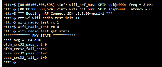

    We have designed a custom PCB using the nRF9160 as the main IC and the nRF7000 for Wi-Fi scanning. The schematic and layout were reviewed by Nordic technical support before production.
    To ensure there were no hardware issues and that all connections were correct, I tested the PCB using the Location and Radio_test samples.
    For the Location sample, I built it for the nrf9160dk_nrf9160_ns with the following settings: -DSHIELD="nrf7002ek" and nrf9160dk_nrf9160_ns.overlay.
    (The overlay file is attached in the first message.)
    Here is a screenshot from the log. From what I understand, the Wi-Fi is working, but the signal strength is weak. This might be due to the need for tuning the RF path components.

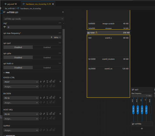

    The first issue is that in both the Location and Radio_test samples, I see logs related to SPI, but in my application, I don't. I'm not sure if this is due to log settings or if it indicates that SPI isn't working.
    For my application, I used the Assert Tracker v2 as a reference and made some code changes, but I didn’t modify the Location module.
    When I check the device tree viewer, it shows that the nRF7000 is assigned to SPI3, and all the necessary pins are set up correctly.
    The key point is that I am now building for a custom board, not for the nRF9160DK. All the configurations and devicetree changes I made to support the nRF7000 are mentioned in my first message.
    I also noticed that I forget to add CONFIG_SPI but this didn't help.
    Maybe there is something I need to add for the MCUboot?
  • I also checked if SPI3, which I am using, was not working simultaneously with another peripheral having the same ID. Everything is fine.
    UART3 and I2C3 are disabled in the zephyr.dts.
    I also tested the build with the following configuration added:
    CONFIG_TFM_SECURE_UART=n
    CONFIG_TFM_LOG_LEVEL_SILENCE=y
    Didn't help also.
    I need your support. We have been stuck and unable to solve this issue for more than a week.
