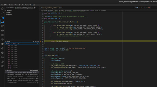

I'm adapting the sample code for TF-M secure peripheral sample (NCS v2.5.0, nrf/samples/tfm/tfm_secure_peripheral) to also add a UART peripheral. But this sample uses the older API (nrfx) which so far I've struggled with finding example code for. I was able to infer from the timer setup in that sample project, and get code working that can do a blocking write, with functions like nrf_uarte_tx_buffer_set() and nrf_uarte_task_trigger(). But how can I perform reads? I need to be able to perform them non-blocking, and interrupt-based.

    The nrfx approach (which was used in the project you got yesterday) was not ideal, as interrupts needs to be handled specially in TF-M and that was not the case ther. It turns out that the cleanest is to avoid nrfx and use the lower-level HAL direcly, in th esame way as is allready done for SPIM in the sample. I put together a very simple sample now which does that: tfm_secure_peripheral_uarte_hal.zip. This is a minimal change from the existing sample in the SDK, but it does work and demonstrate both Tx and interrupt driven Rx. It sends "Nordic Seminoductor" once, and handles incomming Rx data. It does not process the data in any way, and just re-starts Rx when data is received, so to see that it works you can put a breakpoint in tfm_uarte1_irq_flih() before sending data and see taht the uart_rx_buf is populated with the received data:
    In addition to the changes in the secure_peripheral_partition.c file and prj.conf, there are also some changes in the tfm_secure_peripheral_partition.yaml needed for the interrupt handling (search for UARTE1 in that file), this is as described under Secure interrupt in the sample documentation.
