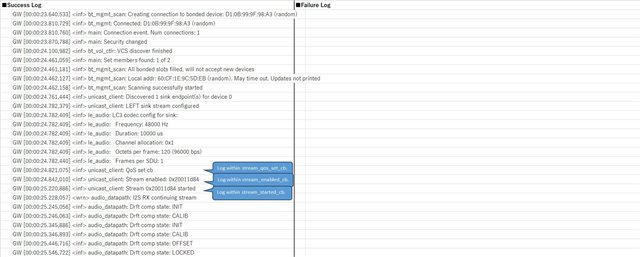

Regarding the behavior of bt_audio_stream_start
The following phenomena have been observed in an anechoic chamber:
  • Success: After the bt_audio_stream_start function is called, the stream_started_cb callback is invoked.
  • Failure: After the bt_audio_stream_start function is called, the stream_stopped_cb callback is invoked, and the wireless connection is disconnected (this also occurs even in the chamber).
Question 1: In the link processing of the SDK2.3.0_nrf5340audio project, during the sequence of audio_stream processing*1, the stream_stopped_cb callback is called, and the behavior of disconnecting and reconnecting the wireless connection is repeated. Do you know the cause? *1: Refers to the bt_audio_stream_config function, bt_audio_stream_qos function, bt_audio_stream_enable function, and bt_audio_stream_start function.
Question 2: When the wireless connection is disconnected, bt_audio_stream_start returns to the beginning and starts the scanning process again. This takes a considerable amount of time, so if there is any workaround, please let me know.

  • >Do you have an application log which you could send?
    Here is the log gotten by EVK.
    Is there anything you think might be the cause?
    Disconnections happen from controller side and restart of scanning probably happens on the application side. As you use deprecated controller which is not supported anymore, it is higly recommended that you update your NCS version.
    Can you please update to the newest NCS version and provide newly obtained log?
    Is there any difference in behavour when you use updated NCS version?
    Dejan
  • Is there any difference in behavour when you use updated NCS version?
    We have updated NCS to ver2.7.0 and tried the same test, and the disconnection didn't happen under the same environment.
