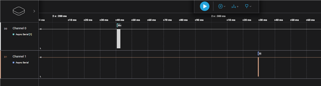

    Now I am able to call img_mgmt_client_upload(). This indeed results in traffic on the TX uart line as the first few transport frames get sent out. The nRF9160 responds with a 35 byte SMP packet after 90 ms. Which looks as follows:
    First 64 bytes of the image sent as SMP frames (nRF5340 -> nRF9160):
    06 09 41 47 67 43 41 41 42 65 41 41 45 41 41 62
    39 6C 61 57 31 68 5A 32 55 41 5A 47 52 68 64 47
    46 59 51 44 32 34 38 35 59 41 41 41 41 41 41 41
    49 41 41 44 6A 56 41 67 41 41 41 41 41 41 41 51
    41 41 41 41 41 41 41 41 41 41 41 41 41 41 2F 2F
    2F 2F 2F 2F 2F 2F 2F 2F 2F 2F 2F 2F 2F 2F 2F 2F
    2F 2F 2F 2F 2F 2F 2F 2F 39 6A 62 32 5A 6D 0A 04
    14 41 47 4E 73 5A 57 34 61 41 41 4C 58 7A 2F 39
    4C 58 67 3D 3D 0A
    Response fom (nRF9160-> nRF5340):
    06 09 41 42 59 44 41 41 41 4D 41 41 45 41 41 62
    39 69 63 6D 4D 41 59 32 39 6D 5A 68 6A 51 2F 37
    47 53 0A
    Unfortunately I am unable to parse it to verify for error codes. This could confirm whether or not the nRF9160 accepts the incoming traffic.
    The issue is that the nRF5340 does not react to the incoming response. No uart handlers get triggered despite uart_rx_enable() having been called, a handler registered with uart_callback_set() and the Following interrupts being enabled
