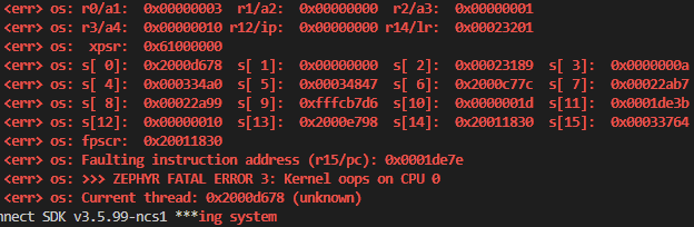

  • Hi Dvl,
    I have tested again with your latest code. Pressing Reset button on the nrf9160-dk board does not change the output for me. In other words, it is "+CEREG: 0,2, ...". However, when I power cycle the nrf9160-dk board I get ZEPHYR FATAL ERROR shown below.
    Using adddr2line on the faulting address
    ncs\toolchains\cf2149caf2\opt\zephyr-sdk\arm-zephyr-eabi\bin> arm-zephyr-eabi-addr2line.exe -e <path_to_your_project>\build\zephyr\zephyr.elf 0x0001de7e
    gives the following output
    C:/Users/desi/ncs/v2.6.0/zephyr/lib/libc/newlib/libc-hooks.c:469
    Can you replicate this on your nrf9160-dk when you power off/on the device?
