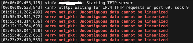

    I have also been seeing this with the nRF7002DK board lately.  My experience may provide some more clues about what is going on:
    • Our app is build with NCS v2.6.2, development is on the MacOS
    • App was built on the Wi-Fi BLE coex sample (the BT code and network processor is currently not part of the project)
    • SSID and password is currently hardwired
    • No special server, just attaching to the local home network with WPA2.  So no certificates, etc.
    • Like funkySanrits, the errors appear sometime after a successful connection, sometimes minutes, but usually hours later.  Our app is idling at the time, waiting for a request on the TFTP server we've implemented, but no app initiated or solicited network messages
    Our app never saw this error in a couple of months of operating on my home network.  It started appearing as soon as I moved my development to Florida for the winter, and thus a different home network.  On the other network I never saw the "Uncontiguous data" error, but I often saw a "net_icmpv6" error instead and haven't seen that error in Florida.
    In this DevZone thread I see that some people see both errors at the same time: devzone.nordicsemi.com/.../516272
    Nothing has changed with the Wi-Fi code in our app since the move.  I've been working on sensor interfaces and hardware designs, completely unrelated to the network code.  So I am convinced that the errors are being triggered by some unsolicited packets from the network, or unsupported or improperly handled background handshaking.
    I let the app run idling overnight and almost always see a few of these errors in the morning.  Here are some from when I took a several hour break from development.  The relative timing of the errors might be of interest:
    This error is printed when there's a buffering issue, ie. where the net_buf isn't able to fully fit the incoming packet. If we look at the sources:
    https://github.com/nrfconnect/sdk-zephyr/blob/main/subsys/net/ip/net_pkt.c#L2174-L2175
    Its a generic printout and effectively does not tell us where it originated from, but there has been issues, especially with regards to ipv6:
    https://github.com/zephyrproject-rtos/zephyr/issues/66639
    Which was addressed with this commit (included in NCS v2.7 and newer):
    https://github.com/zephyrproject-rtos/zephyr/pull/66532
    As you mention v2.6.2, it could be this issue that you're seeing.
    Håkon

    To be able to determine how to fix the issue, it is crucial to know where the error comes from.
    In your case, I can only guess where the error message came from, but to be certain, you should test and set a breakpoint on the line that prints this to see if the callstack is then similar to what is shown in the below linked issue.
    If you still see issues, I would recommend creating a dedicated thread on the matter, as it is highly likely that the issue is not the same as the original issue here, due to the generic nature of the printed error.
