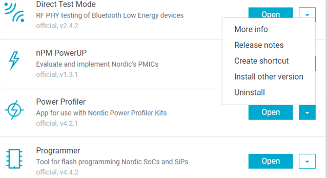

- Using Programmer v4.0.1 can successfully read the NRF51822AB, but upgrading to the latest version 4.4.2 results in a failure to read the device.
- Additionally, after updating to version 4.4.2, JLINK in the VSCODE environment is unable to detect the correct device.
- However, using JLINKEXE works without any issues.
You would also need need to downgrade the Jlink as I suspect it is what may be causing the issue
